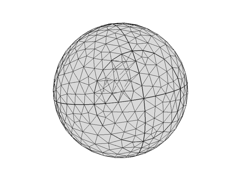

Re: Internal error in boundary respecting
It's so abnormal that the program gives such an error, since I have such 8 boundaries, but it gives an error about only one of them. Mesh looks like in the picture. It shows the problematic boundary.
how I created the geometry:
after creating two cylinders and one sphere, I intersected one cylinder one sphere with keeping input objects, so I created middle domains that are created by the intersection. Then I used delete entities to delete the remaining parts of the cylinder.
The result is one sphere with two caps at opposite ends.

Attachments:   res-14795.png

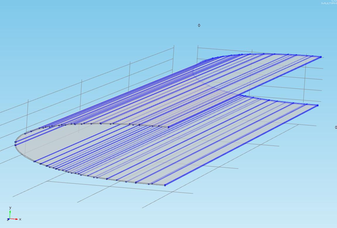

Hello
I am trying to mesh the geometry as shown in the attachment. It has a thickness of about 0.05inches.
I tried to mesh using most of the mesh options available in 4.3a version, but still the error persists.
May I please know how to work on the problem?
Attachments:   thingeomt-23365.JPG
Andrew Kiernan
Andrew Kiernan
March 11, 2015 4:30pm UTC in response to Karan Bikkannavar
I am aware this reply is late but if anyone else comes to this thread for advice on meshing,
I would have used a free triangular mesh on the arc then swept through the rest of the domain with a distribution and finally used a converted to change the squares created by the swept mesh into triangles.
Andy
