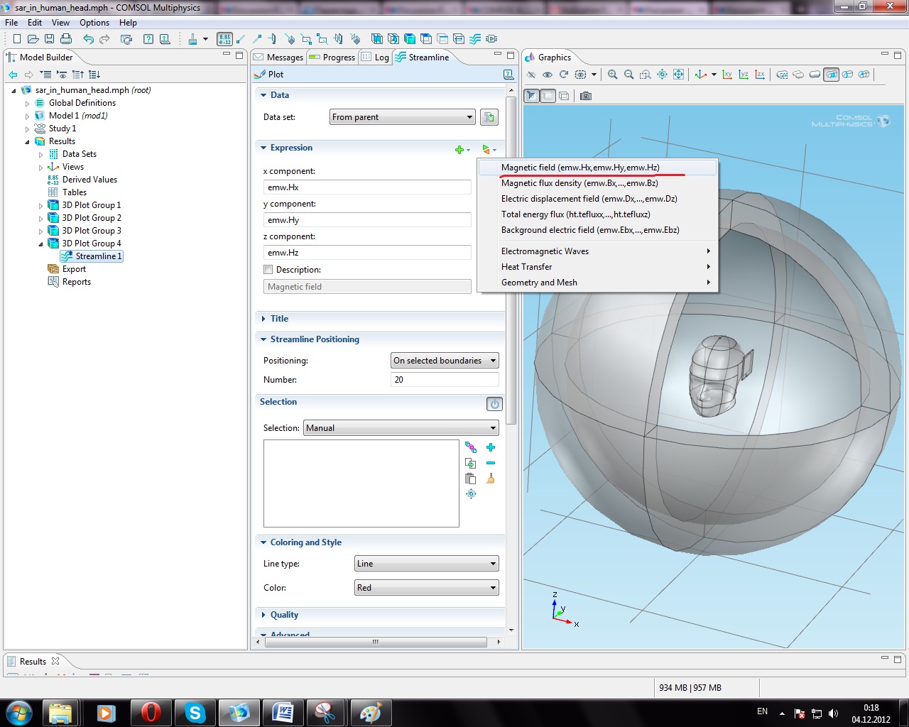

Hi all!
I need to add the magnetic field lines (and possibly add metal bars between the head and emitter) to the model 2190 Absorbed Radiation (SAR) in the Human Brain.
PS Since I'm a beginner, then I ask (if possible) to provide input data for example.

Dima,
Use the following steps to create magnetic stream lines:
1. Results>3D Plot Group
2. 3D Plot Group 1>Streamline
3. In the expression to plot, define Magnetic flux density vector {Bx,By,Bz}, or Magnetic field vector {Hx,Hy,Hz}
4. In the Streamline Positioning section, adjust streamline parameters to get nice plot for magnetic field lines
Good luck,
Sergei Yushanov

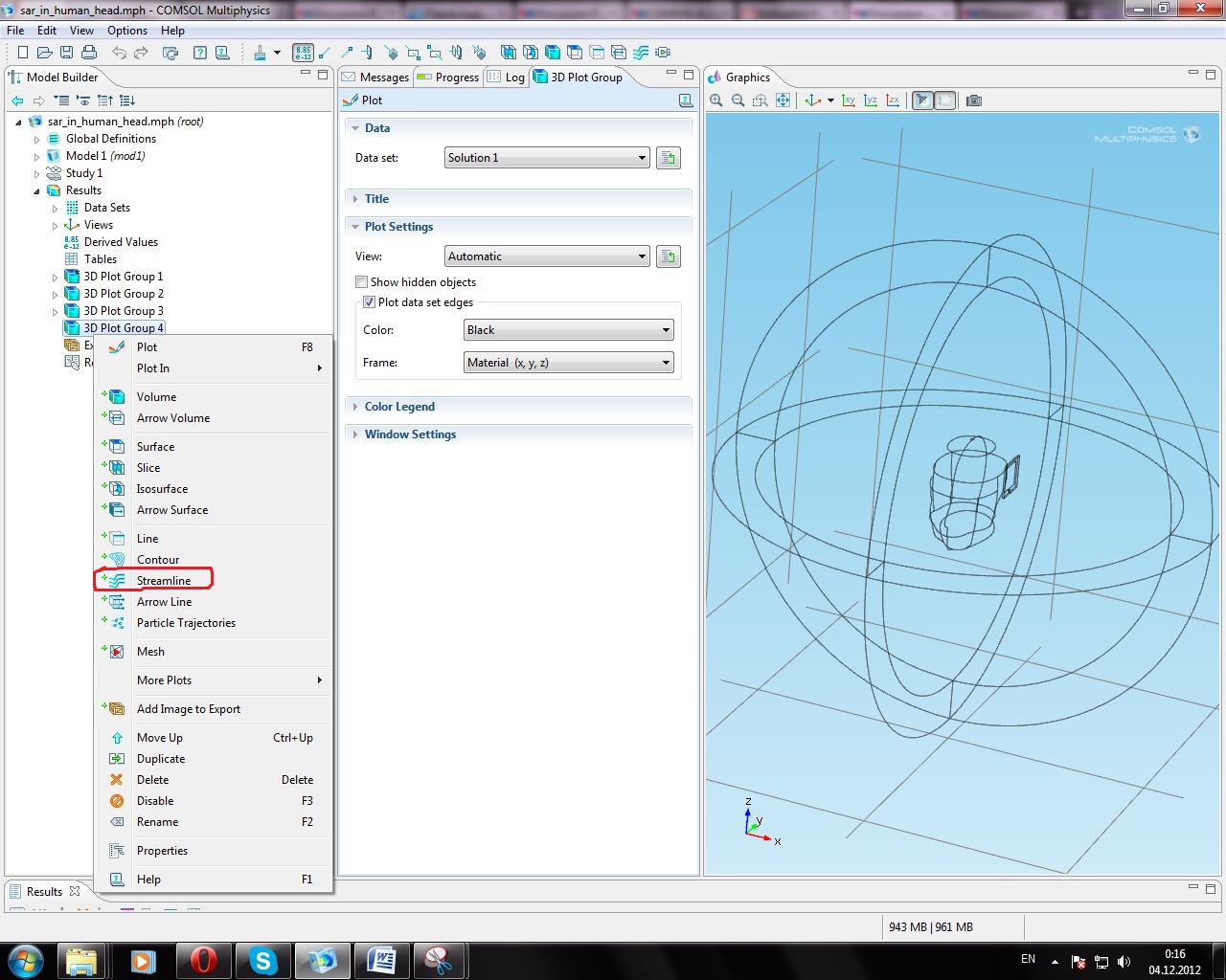

Thank you!
But I've done it before. And the result was not granted me.
Maybe I'm doing something wrong?
Attachments:   1.jpg   3.jpg   2.jpg

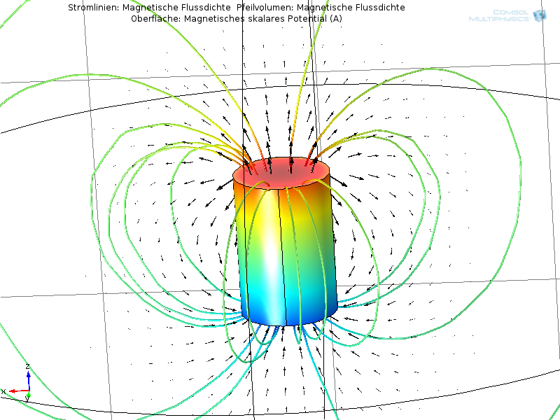

Hi!
Something like this? You can play a lot with 3D plots ;-)
Ralf
Attachments:   PM_example.mph   PM_example.png

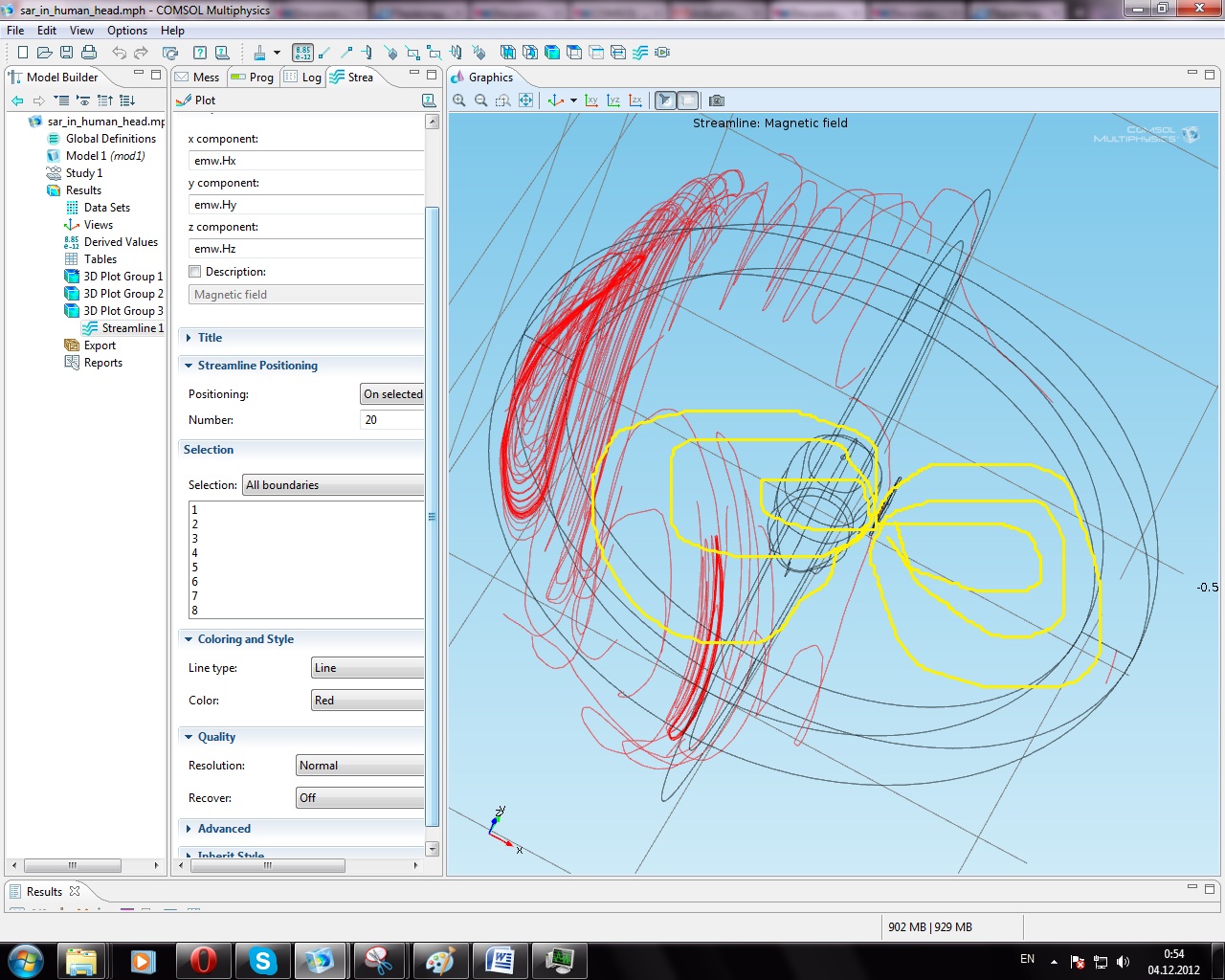

Hi!
Yes I want that! But somehow nothing is drawn. =(
In the graphics tab - empty!
Attachments:   4.jpg
Ivar Kjelberg
Ivar Kjelberg
December 5, 2012 6:33am UTC in response to Dima Ilchen
Re: Help me please! how to draw the magnetic field lines in 3D, as
check the sub nodes of your plot, something is not set-up correctly, or you are not pointing to the right data set, there can be many things.
Have you gone through the doc to understand what the different tab and entries do ? usually the most important are coming first (on the top)

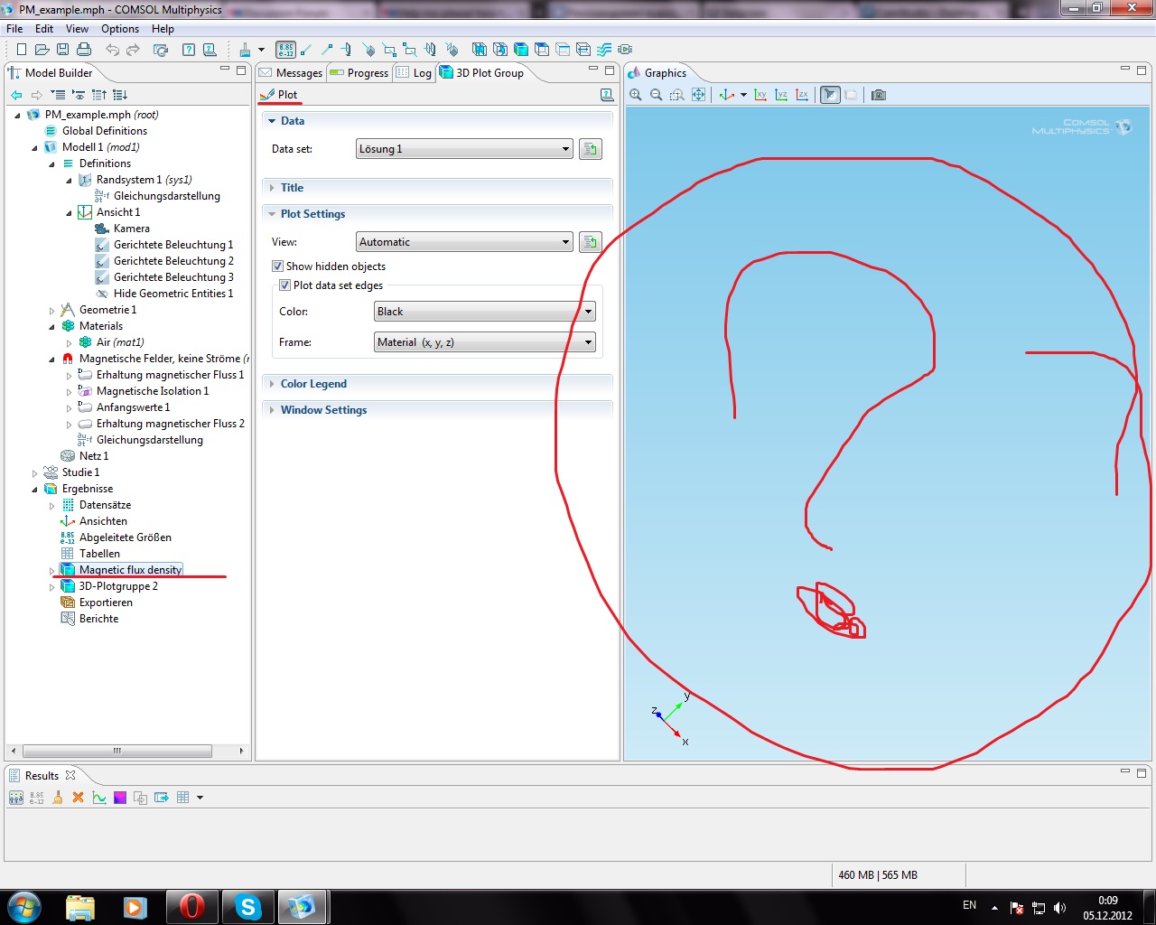

Ralf Tschiesche
Ralf Tschiesche
December 5, 2012 10:25am UTC in response to Dima Ilchen
Hi!
I have cleared the solution to get a small file...you only have to re-run the simulation.
Ralf
