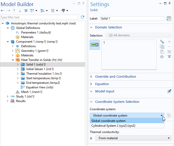

I wanted to do something similar, but for thermal conductivity instead of thermal expansion coefficient. A cylindrical coordinate system under definitions in the component has been added. However, I can't find any option to change the coordinate system in the materials model. See the attached file for a simple test file. Does the option to change the coordinate system exist, and if so, where?
Best regards, Claes
>You need to do the following: > >1. Add a cylindrical coordinate system under *Definitions*. >2. Select the cylindrical coordinate system in the material model (*Linear Elastic Material* in this case). >3. In the material model under *Materials*, go to the *Thermal expansion* node. Select the property (*Tangent coefficient of thermal expansion*). Then click the *Edit* icon, and enter the data in the popup dialog. Hi Henrik, I wanted to do something similar, but for thermal conductivity instead of thermal expansion coefficient. A cylindrical coordinate system under definitions in the component has been added. However, I can't find any option to change the coordinate system in the materials model. See the attached file for a simple test file. Does the option to change the coordinate system exist, and if so, where? Best regards, Claes

I may not understand your question, but attached is a screenshot showing the coordinate systems selector that I see when opening your model.
