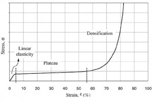

I'm trying to implement Ogden's model for polyurethane elastic foams into COMSOL. Currently, I'm working with the structural mechanics module and trying to model the uniaxial compression stress-strain response of these foams. The tend to behave in a non-linear fashion and a typical stress-strain curve is attached herewith. As I'm new to COMSOL, can anyone suggest how to change the governing equations and boundary conditions and preferably some tutorial on the equation modification process.

I believe you could start with entering the non linear curve into your material properties (ie. make a custom material), I would also suggest to start with an isotropic material (even if wrong) and when your happy with your model , only then make it anisotropic.
I do not think you need to change anything else. In fact, you do not even need to make a "custom material", you can start to define your "function" and type it straight into the subdomain material properties, but for later its usefull to enter as a custom material.

Thanks for your efforts in replying. Yeah I will try to work in the way as you suggested. Actually, my material in not anisotrpic, but it behaves non-linear in any direction of load invariably.

But if I had to reply, I would use the solid structural module, import/create your geometry, define the material variables on the subdomains (and for you define a function based on the material non-linear shape with corresponding comsol I/O variables), define the load/fixed etc BCs and run a solve.
but I beleve you must use the detailed matrices for the material properties as you will not have standard E and nu expressed in a simple form, but if your material is isotropic, you should not have too many items to fill in.
