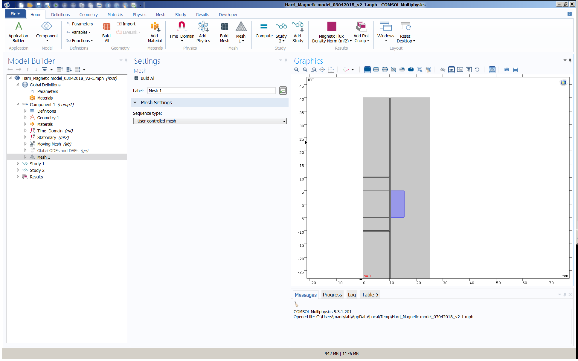

I want to excite coil with vector potential. Is there any possible way to do this? I have tried by adding Initial Values 2 in Stationary in Component 1 and there giving some phi component of vector potential in coil which is the area highlighted. Then I have tried solving the current in the coil but It does not give good results. Is there a way to solve current in coil for a given vector potential?
