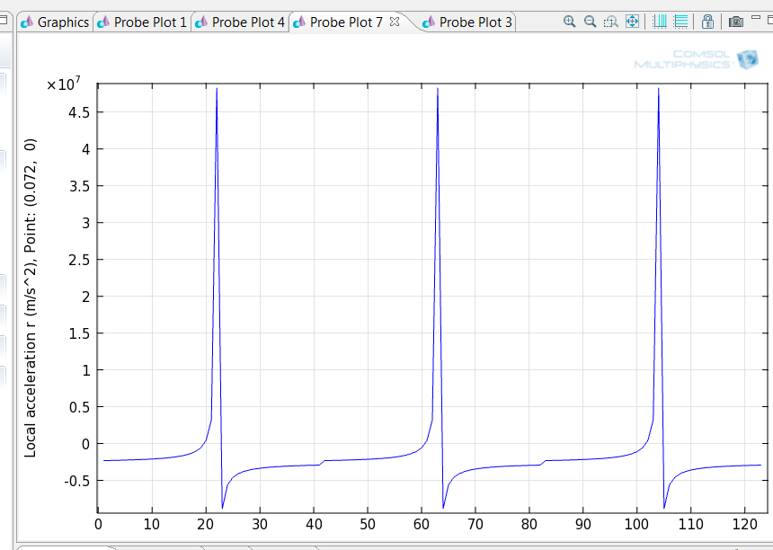

Does anyone know how to get the desired graphs axis from the table when using a continuation parameter and auxiliary sweep, study 1 and 2 respectively?
Initially the probe plots (9total) is a 3 spikes (acceleration vs. number of values computed consecutively for each corresponding user-defined internal pressures). I've chosen 0 300 600 psi, respectively.
When running the Pre-stress (study1) and then Frequency Domain (study2) the Result tab shows a generated tables values with accelerations (i#) for the 9 probes mounted onto the shell, evaluated over a frequency 16905-16920 Hz, step size 0.25. When the calculations are re-run the 3spikes now has a different x axis replaced with ExtPressure, not 0-123 steps (41 for each pressure defined), which is the consecutive sum of the frequency range/step size for each pressure evaluated. The issue may be a Parameter problem. Both desire 3-peaks and the generated plots w/ x-axis EXTPressure have the same Table values, just different representation.
How can I get Comsol to generate the initial 3 spikes with the # of evaluated steps on the x-axis for different external pressure say: 0 100 600 psi every time we compute study 1 & 2 is re-computed from initial file state?
I ignore the irrelevant study 3 (eigenvalues) .
See attached problem file and Pictures of the two desired probe plots with the right x-axis.
