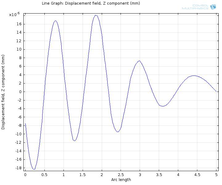

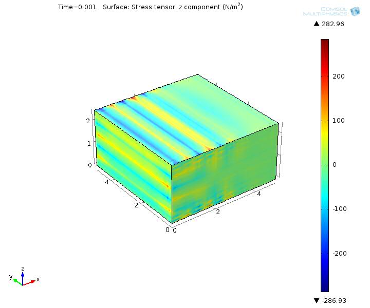

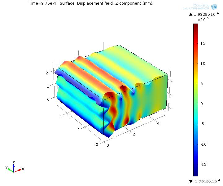

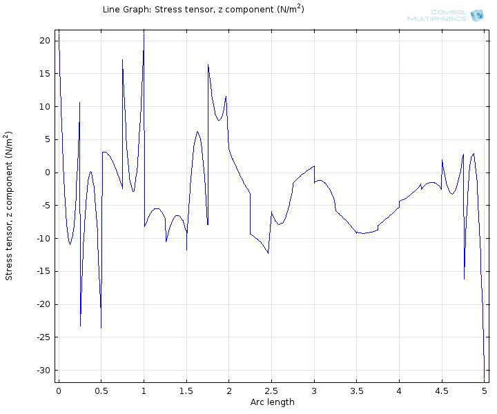

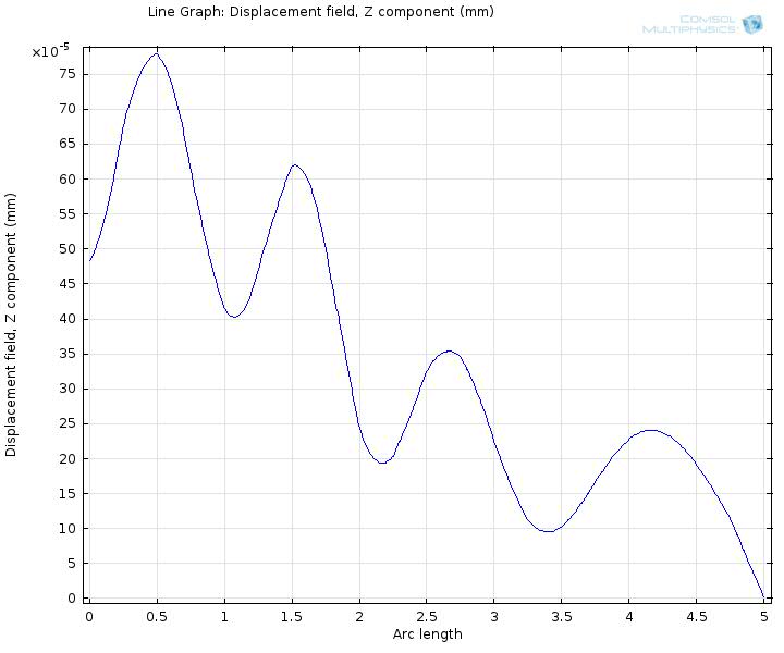

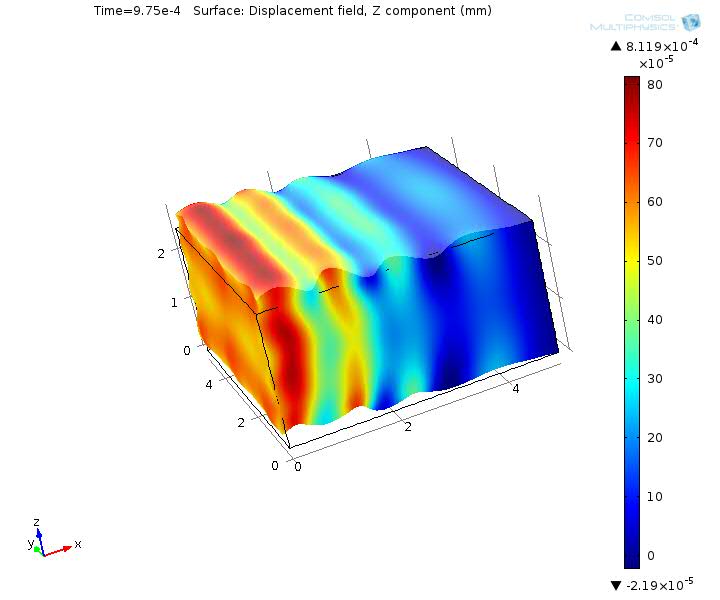

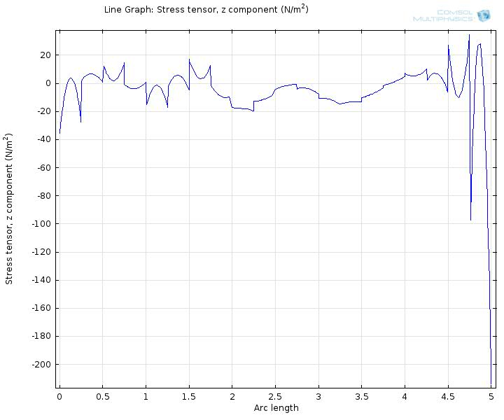

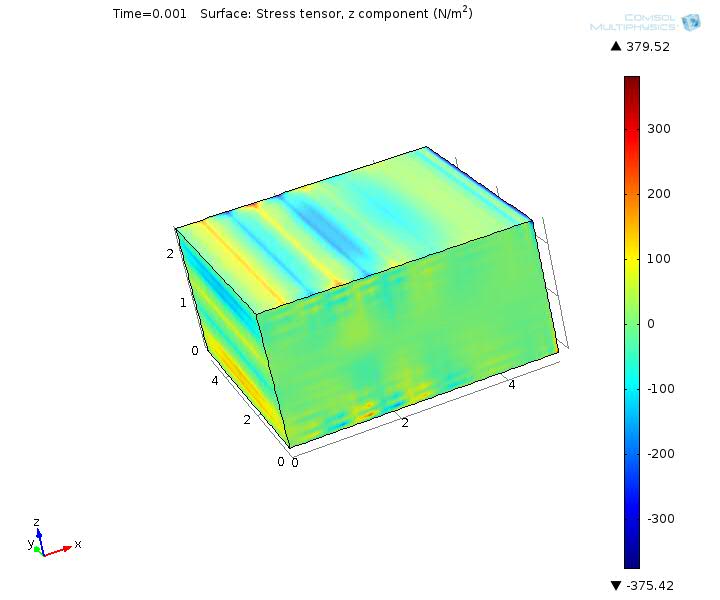

Yes you are correct in assuming that I was looking at Mises, and you are also right that when I look at individual stress components I do see a sin variation (see fig. 1,2). However this same sin^2 profile shows up for displacement as well and that is what I'm most concerned about. Let me show you 2 sets of images the first set shows the results when I use the S_0*sin(2*pi*f*t) function, and the second set shows the results for the S_0*exp(i*2*pi*f*t) function.
Also, to be clear my goal is to produce a shear wave propagating through this material. In the pictures the left face (y-z plane) is under harmonic stress (in z-dir.) and the right face (y-z plane) is fixed.
Note: 1D plots are taken along a line just below the top surface
I am mostly concerned with the difference between figures 4 and 8. Fig. 8 more accurately resembles experimental results. Therefore my conclusion is to still use S_0*exp(i*2*pi*f*t) instead of S_0*sin(2*pi*f*t).
