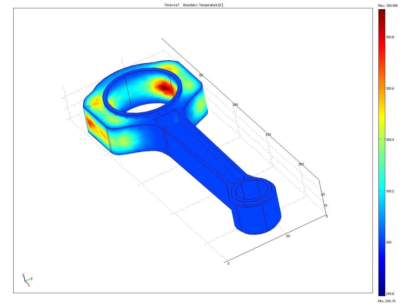

I'm working on a project to model a connecting rod of an internal combustion engine and running into ridiculous data output. I am taking the rod to be at melting temperature and trying to cool it to room temperature.
I have a very simple CAD model of the rod and imported as an STL file.
The sub domain boundary settings were based off of the material library for AISI 4340 Steel.

So after running the simulation, it takes a long time for the model to cool to room temperature. Example would be setting the time to 1*10^7 seconds. The exterior of the rod would be at room temperature, but a slice plot shows certain internal areas to be still at around 1800-2000K. This occurs around the areas where the two large holes are for a connecting rod. Even at lower time intervals, such as 1 hour, the max temperature actually rose higher.
As a test, I ran a simulation for a simple 3-D cube with comsol library material properties for AISI 4340 with constant properties. The plot still shows that the internal temperature is much higher the exterior after running with a large time interval. The cooling time just does not make sense.
Some advice that was given to me was to impose q for the boundary conditions.
As an example of what I am working with, I have attached a temperature distribution of the rod with a time scaling coefficient of 1/60. Note the the time at the top of the graph and temperature scale on the right. I don't have access to comsol at the moment, so I can't get a sliced view.
