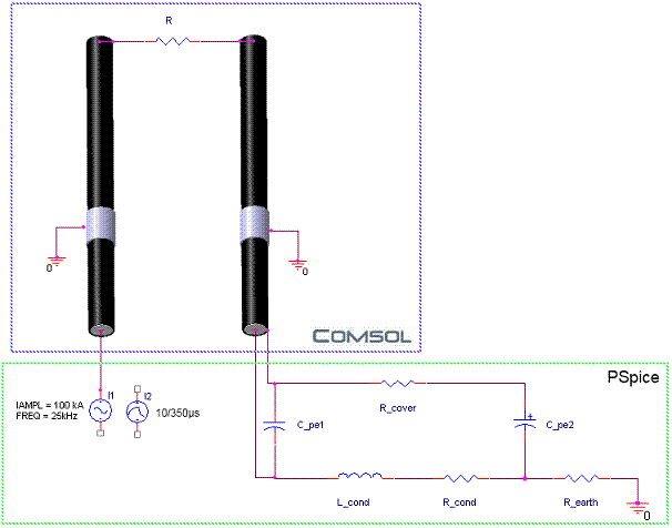

Hallo. I have task with cable which is covered by think covering (1.3 mm) and to this cover fixed one fastener. The problem is the meshing of cover require a lot of memory and PC resourses. Could I in some way solve this problem without CAD presenting of cover (e.g. by Contact Resistance function (CR))? I dont know what I must do then with radius of the fastener when I take a way the cover and will present this cover by CR function.. Thanks for advantage.

modelling complex assemblies (even often simple ones too) is often tricky.
You should analyse your model to see if you can use symmetry (not only on the geometry but also on the boundary conditions), and if you can decompose the model into sub items: doing a rough calculation on most of it ans use the results as input to a more detailed analysis of some specific critical item

Thanks for your quick answer. I will try in some way to simplify the model or make partly calculations.. By the way i attached the picture of the task. The model I put in the air. Maby you could see more because I didnt see how I can use symmetry. The task is research electric strentgh between the cables. The critical point (of max value of the electric field) must be near of the point combination of air, earth fastener and covering. I couldnt make smaller the cable length because there is effect of equalised electrical field at the surface of cover. Thanks a lot.
