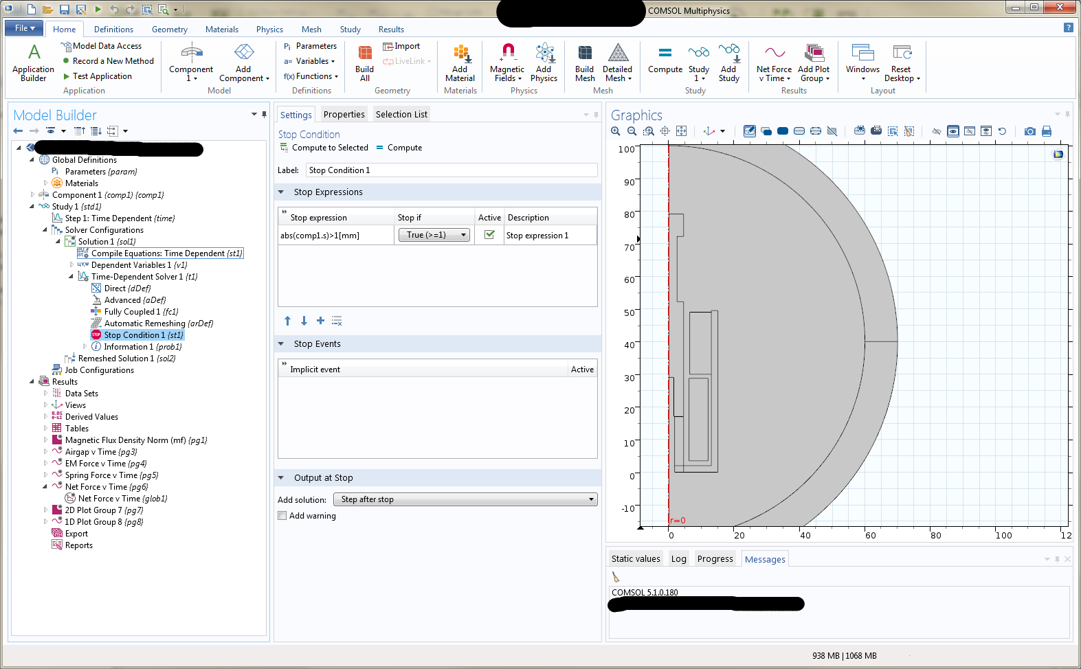

You need to add a stop condition to your solution, so for example if you have a displacement of "s", you will need to add a stop condition for when "s" exceeds a certain value, see attached screenshot.

The stop condition can be added by right clicking on your time dependant solver and entering an appropriate terms for the stop condition. In my model, I have set the solution to stop when the magnitude of the plunger displacement is greater than 1mm.

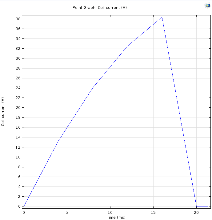

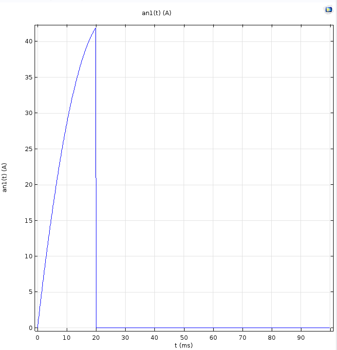

I am energising the coil by applying a current pulse and the calculated coil current is of the shape in the attached screenshot.
Based on testing in the geometry I am modelling, this current pulse is sufficient to move the armature by 12 mm, so the armature does not reach 17 mm, as it happens in my model. Any ideas?

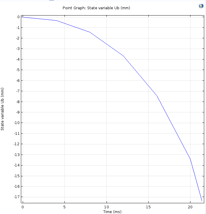

I have attached some screenshots of the current and displacement.

Based on the experiments we have done in our test facilities, the current pulse I apply allows for a movement of the plunger of 12mm after 60 ms. In my model, the plunger reaches 17mm after 16 ms, so I think or I am not including all the forces, or I am defining them wrong. Really what should be happening is for the plunger to reach a certain value of displacement and stay there.

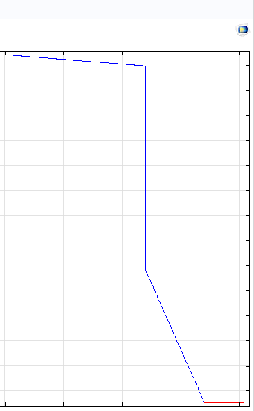

In my case, based on the experimental data, the plunger moves about 8 mm and then it needs other 8+5 mm to latch eventually. So I have defined a piece wise function e.g.
From 0 to 8 (mm) : I have a force which helps the plunger to de - latch from its initial position
From 8 to 13 (mm) : Preload (Constant) + k *(u-8),
where u is the displacement defined as a variable in the global equations.
I attach you a screenshot that may be helpful for you (the y axis is the force and the x axis is the displacement. so at 8 mm, you can see the preload (straight line going down) and after that the spring force is acting.
