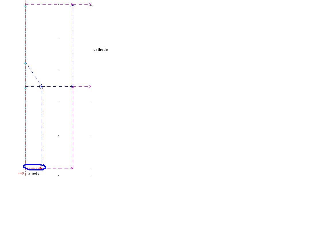

The best result i got in 3D was: anodic current 0.808 A, cathodic current: 0.695A. As you can see they differ 0.1 A, but it tells me that the current must be between those two values (0.7,08)
Now, I do the 2D ax sym model, and I refine the mesh as much as I can, ending up with 0.792 A for the cathodic current. (may be right)
However, in 2D I don't know how to calculate the anodic current since it is the integral of a line parallel to the r axis.
In this case I cannot multiply by 2*pi*r (see attached pic). Any ideas?

heres the pic.
regards,
Antonio
heres the pic. regards, Antonio
Of course you can!! Why not?? The revolution of (2*pi*R) of this line which is parallel to the axis would give you a cylinder surface!! NO??
I have built the same model including your geometry (I am sorry but the 3.2 is in the Comsol museum ;-) )
And the currents are
1.542469 A for the top electrode.
1.542634 A for the bottom electrode.
Good luck man,
