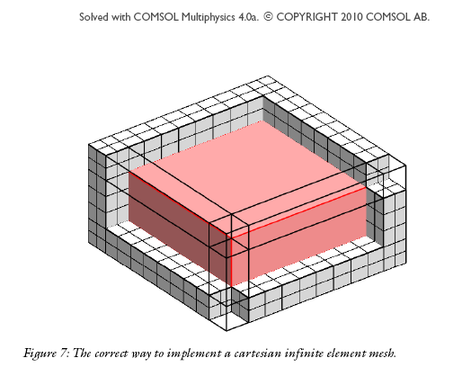

I have attached a model fie, a dipole excited by a lumped port and within a cube of air. The BC on cube is PML.
It is giving me error with PML, however if I use scattering BC instead of PML , it works.
Can any one look into this, what is wrong in PML implementation

first I would advise to use a sphere with cylindrical PML and have it meshed as a few quad-sweep layers, or if you use the square cartesian cut your volume up into blocks such to use quad-sweep/block for the PML.
Then I do not usderstand how ou set up your dipole, you have 1V for bot tubes, but no reference ground ?
HI first I would advise to use a sphere with cylindrical PML and have it meshed as a few quad-sweep layers, or if you use the square cartesian cut your volume up into blocks such to use quad-sweep/block for the PML. Then I do not usderstand how ou set up your dipole, you have 1V for bot tubes, but no reference ground ? -- Good luck Ivar

Thanks, can you please guide me how to cut cube volume into blocks. The dipole is excited as in tutorial and Idid use it with sphere and PML. I could not able to run on Cartesian PML.

just cut your cartesian PML section not into one hollow cube but into rectangular blocks, one in each corner (4x) one on each of the 4 edges, and one on each of the 4 main sides. In this way you can mesh it easily with blocks
Hi just cut your cartesian PML section not into one hollow cube but into rectangular blocks, one in each corner (4x) one on each of the 4 edges, and one on each of the 4 main sides. In this way you can mesh it easily with blocks -- Good luck Ivar
