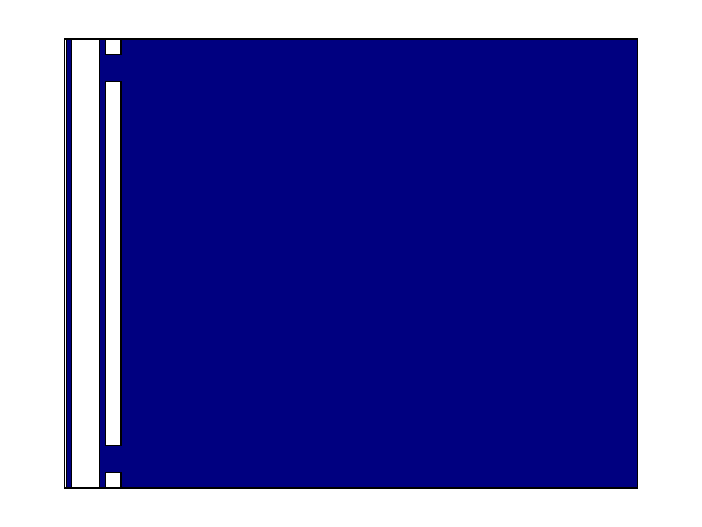

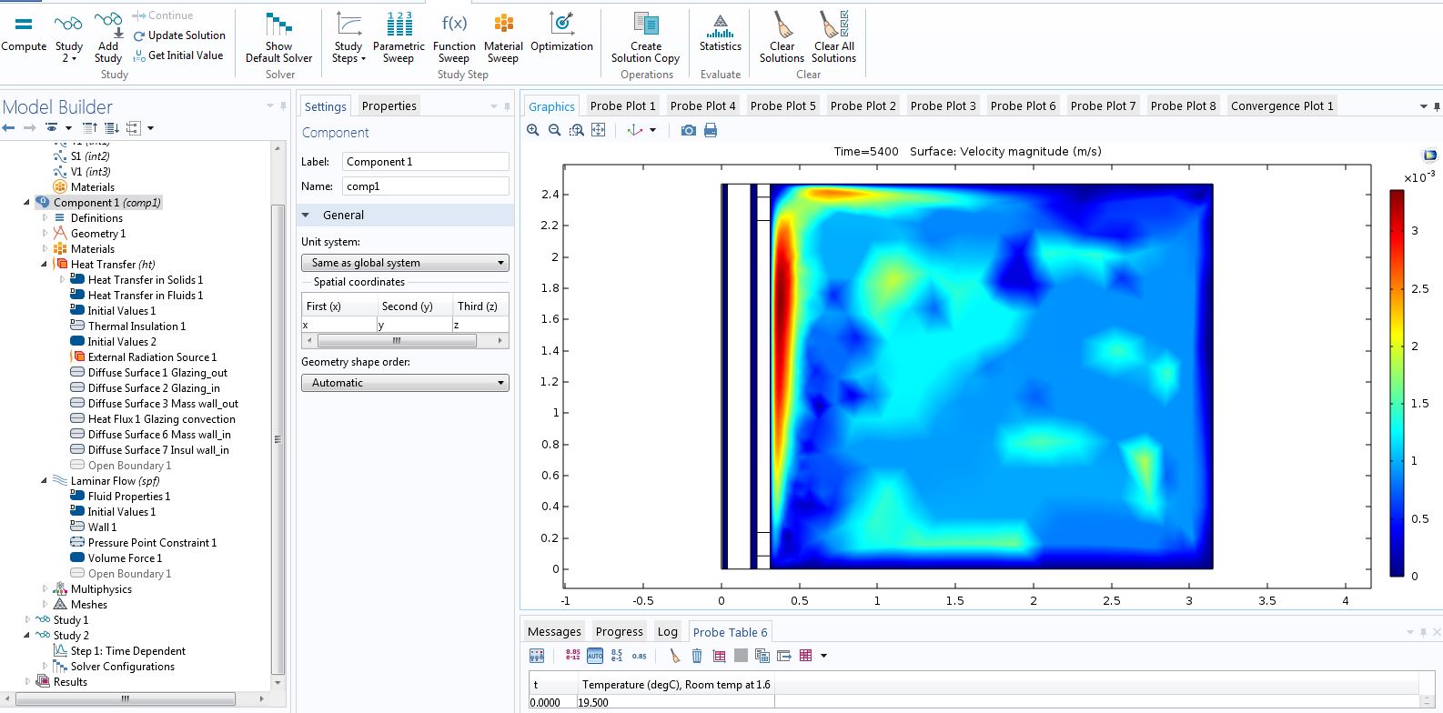

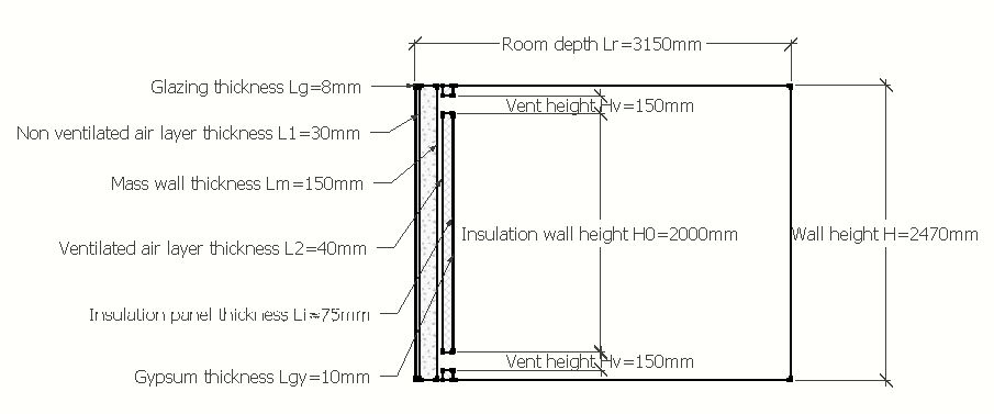

I'm building a time dependent model of passive heating wall called composite Trombe wall in COMSOL 5.1 with heat transfer and laminar flow modules. The geometry and model set up files are attached here, along with a flash gif. file to show how the air flows in the system.

Neither of them seems to work well for me, especially after I added "volume force" in fluid domains to create natural convection.
