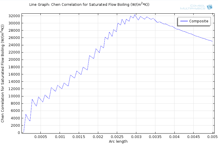

My problem has to do with using heat transfer coefficient correlations and "noise" in the solutions. In general the solutions seem correct physically, but they are very "jagged(see attached)." I believe this is causing problems with convergence when I try to apply more complicated HTC correlations. This "jaggedness" persists even when the mesh is refined.
Is there a way to smooth intermediate solutions? By intermediate solutions I mean the solution passed from one iteration to the next.
