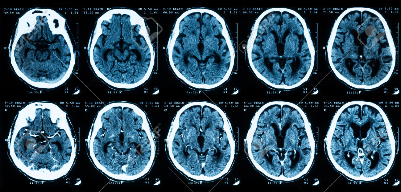

Hello Mr. Robert,
Thank you for your answer. It had solved almost my problem. Now, how to display slices plot like CT-scan result (I sent a picture of CT-scan result. Please, check it). It's possible or not for COMSOL? If it's possible, how do I do?
Hello Mr. Robert,

Well, I don't normally display slices that way. I suppose you could export the individual slices to MatLab or another application, then arrange them that way. Perhaps another user here can offer a simpler or better suggestion?

You can use the Deformation attribute to achieve this effect: If you want to display an M-by-N grid of plots as shown in your example, then you create a 2D plot group containing M*N plots where each of the plots has a difference deformation. You need set Scale factor to 1 in the Deformation attributes for this to have the intended effect.
