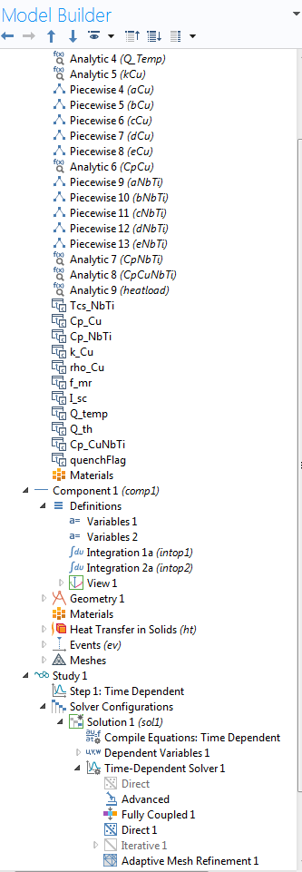

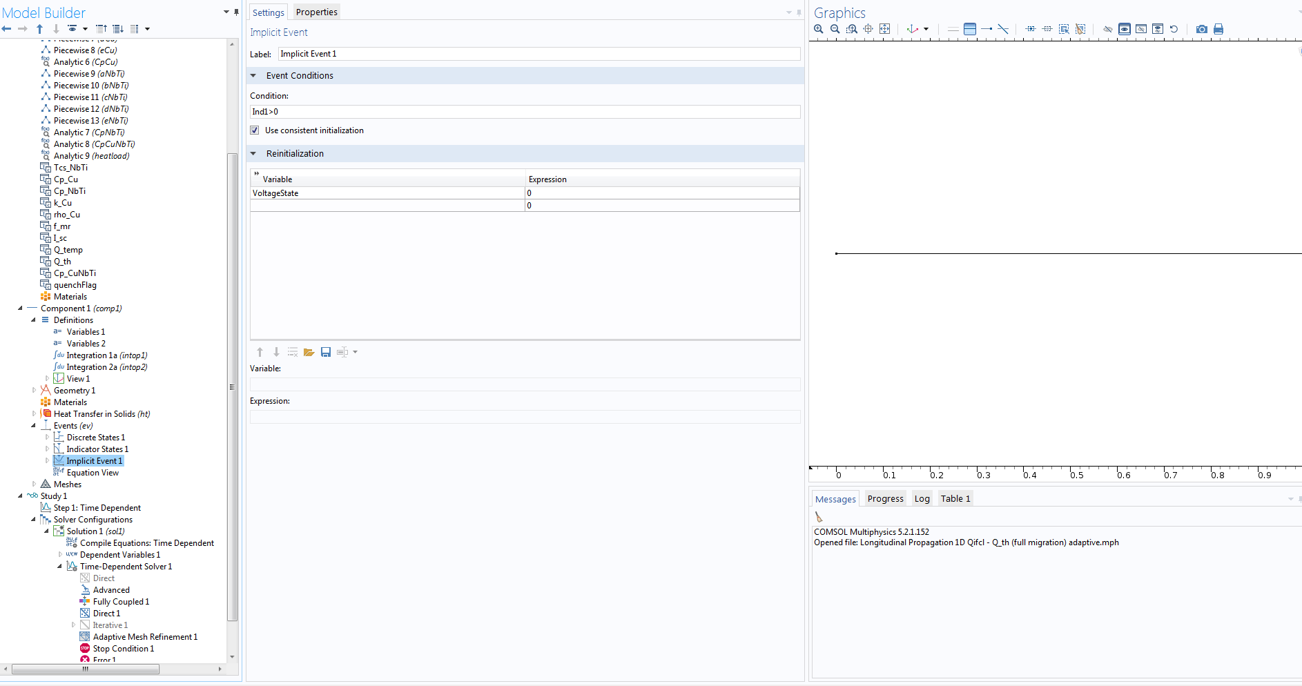

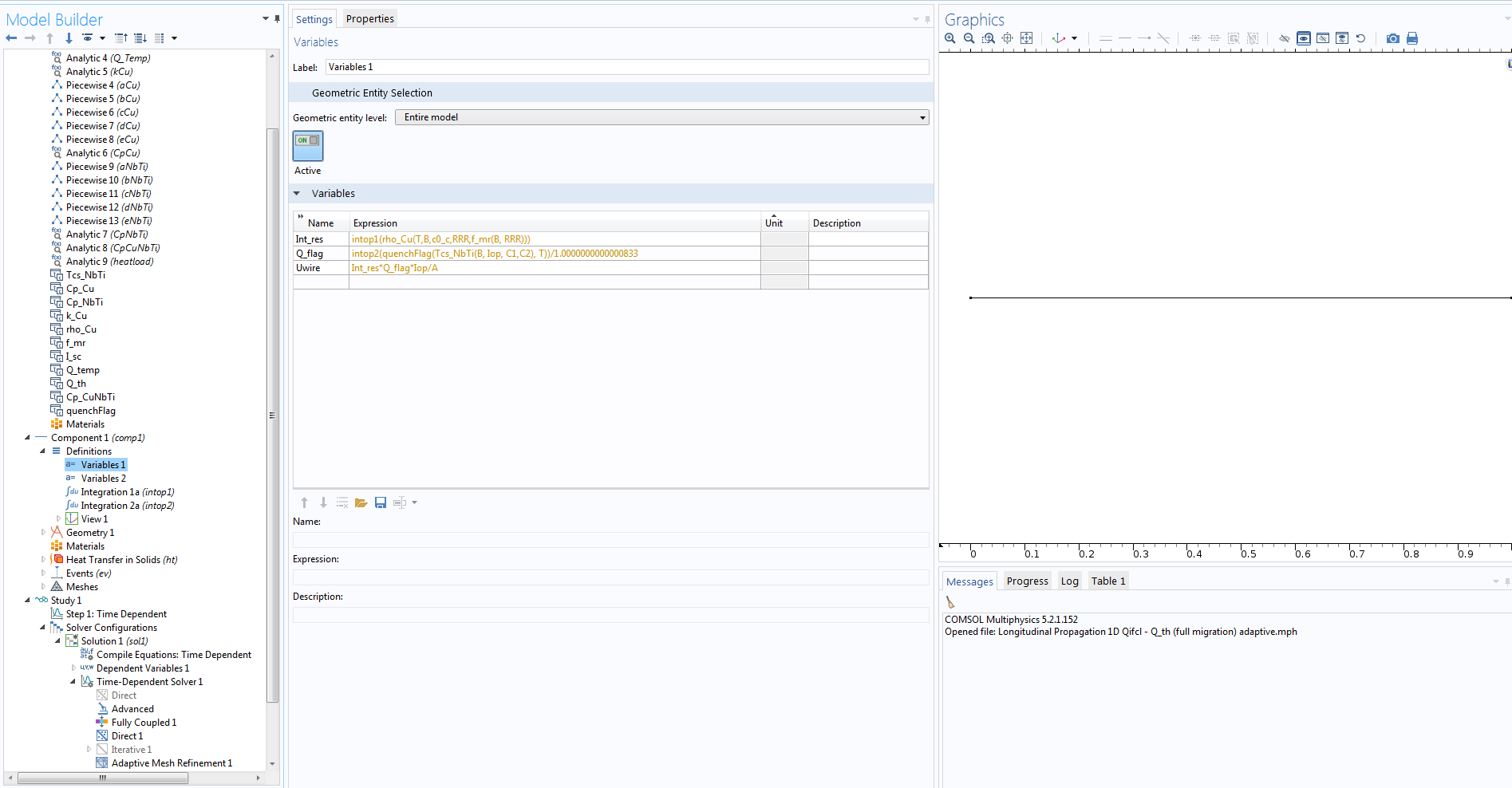

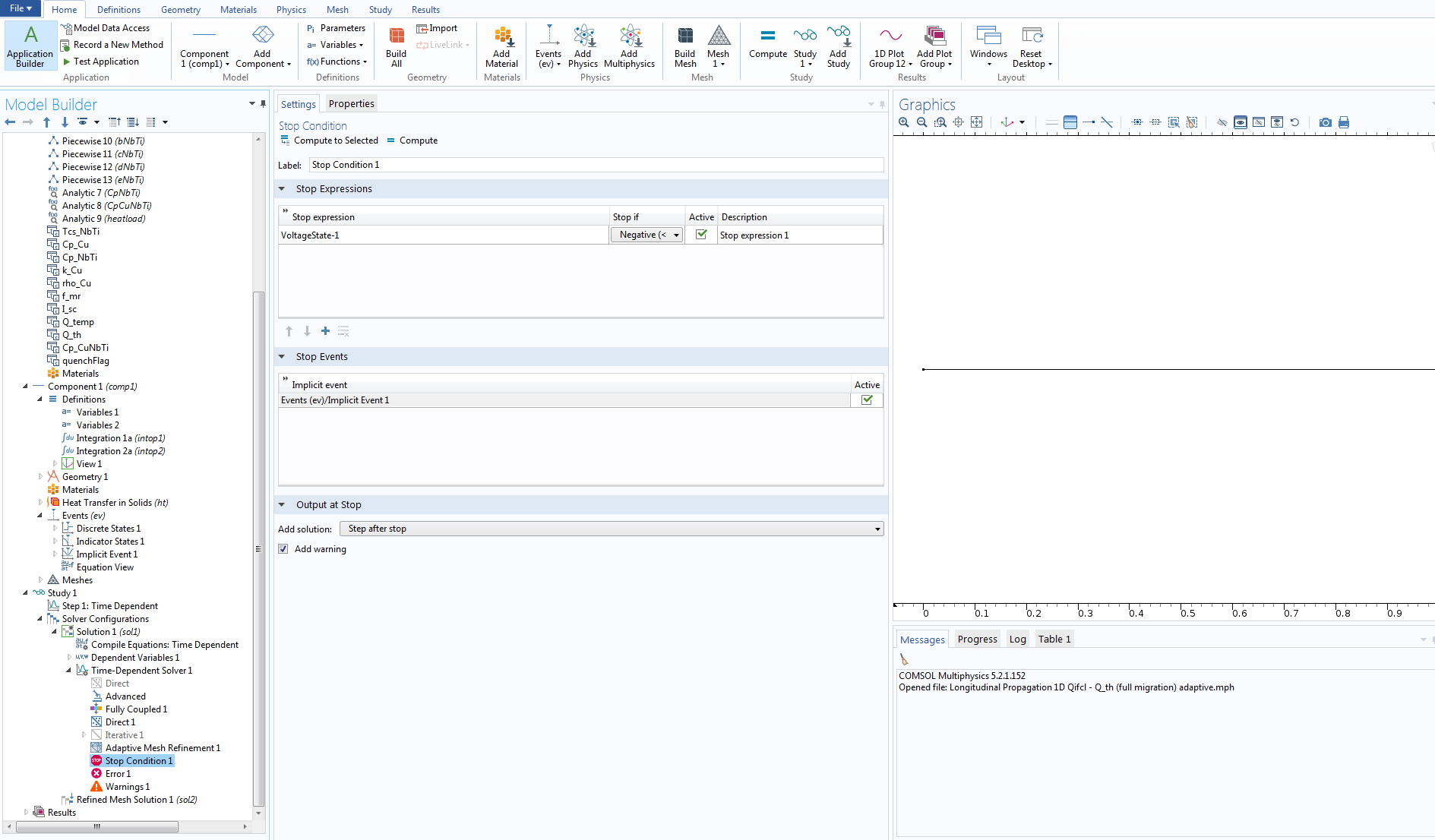

I'm simulation ID wire, and evaluating the voltage over the wire at different time steps. I want the model to use a time-dependent solver, such that the simulation stops when Uwire reaches 0.1 V. The problem is that I do not know how to refer to the variable Uwire in the stop condition. I tried adding an event, but the same problem still persists. How to instruct COMSOL to stop simulating when Uwire reaches 0.1?
The model is too big to attach so please consult the picture.
