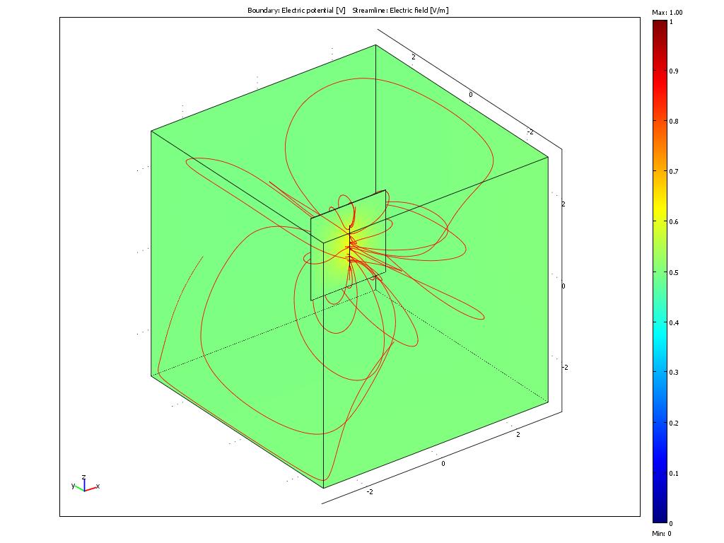

I'd like to determine the capacitance between two wires a metal plate inserted between them to act as an electric shield. In the COMSOL 3.3 AC/DC Module 3D Electrostatics Application Mode I set one of the wires to the "port" boundary condition, set the other to "ground," and set the plate to the "electric shielding" boundary condition. The wires and plate are surrounded by a large box with the "zero charge / symmetry" boundary condition applied at its six surfaces. My geometry and an image of my simulation results are attached.
My problem is that the electrostatic potential varies across the surface of the plate. For a conducting metal plate, the potential should be constant everywhere on its surface. Evidently COMSOL is treating the plate as non-conducting.

there are probably not many people using 3.3 any longer. I checked in 3.4 Electrostatics, generalized and didn't find an 'electric shielding' BC. Did you choose 'electric insulation' instead? This would explain your results.Electric insulation does not shield the electric field, it only shields the current field.
To model an electric shield, your plate subdomain must be conducting and you keep it either floating (continuity BC) or you ground it or you apply a potential, Depending on what you want to model.
