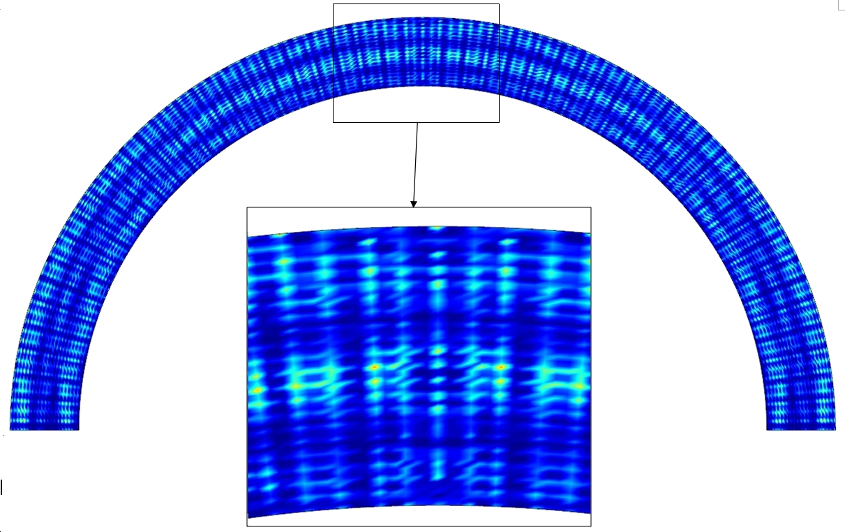

The only thing I find weird is that if I put my longitudinal elasticity modulus (E11) in the "phi" direction (i.e. following along a layer as if it was following a fiber) and my transversal elasticity modulus (E22) in the "r" direction (i.e. passing through the layer, normal to it) I see really weird stresses that seem to be stuck between layers and mesh.
(see PICTURE 1 in attachment). My E11 is about 15 times higher than my E22 so I would thought that more stress would develop tranversaly and not along the fibers.

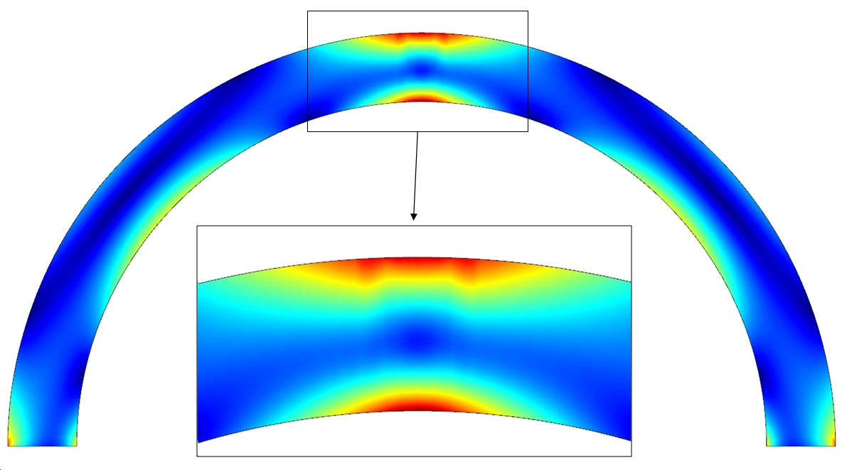

If I reverse these (put longitudinal E11 along "r" and tranversal E22 along "phi") I get a nicer stress pattern (see PICTURE 2 in attachment) but I don't think these are the right E11/E22 directions.

but what "smoothing" are you using in your display ? and do you really have more than 1 element per layer ?, if not you will not really see a correct gradient of stress across your layer thickness.
