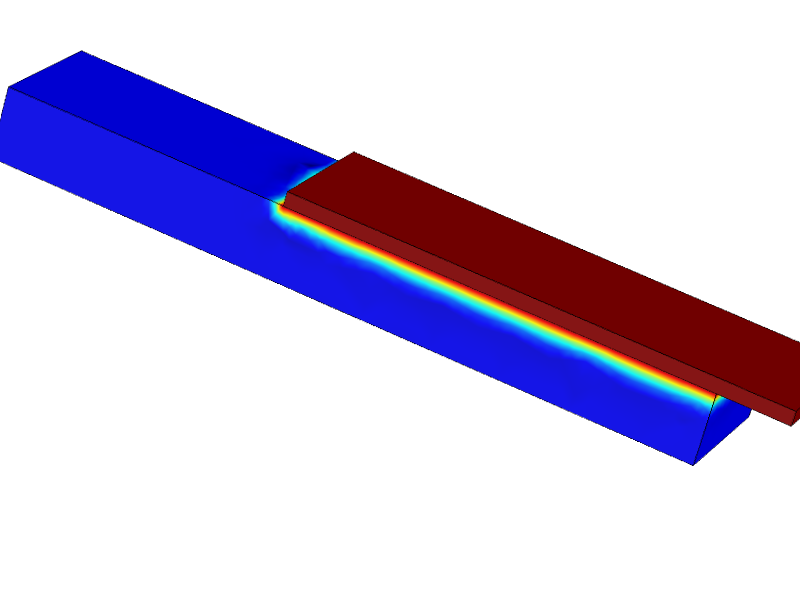

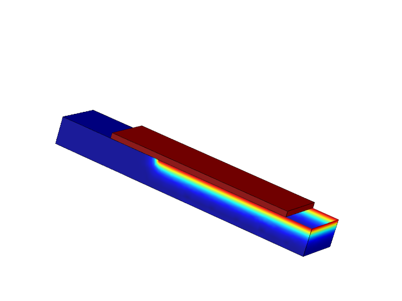

Hello Gabriel
I think I did the same thing but what I have in results is just a box (as my heat source) in 3 positions and in each position it acts for 5 seconds in each case for example from 200 to 300 degree of Celsius. but the other box which is in contact with it under it is effected completely independent of the last step :( . I need the temperature contour on the bottom box to keep the results of each of the three steps :(.
what is wrong with me, I do the same :( but no temperature trial.
maybe I have not said my problem clearly because of my english problem, but I think we had same problem. I have attached a picture please take a look at it. I want the upper box moves along the bottom one and in each step stays about 0.5 second, the box has a constant temperature (which I should change for next step and make it caused to effects from the cold bottom box) . so using the parametric sweep makes independent temperature contour in each step :( even when I change it from results. It looks like we can not add temperature results from previous step to the new step and go through it :(
I appreciate your helps a lot.
sincerely
Hello Gabriel I think I did the same thing but what I have in results is just a box (as my heat source) in 3 positions and in each position it acts for 5 seconds in each case for example from 200 to 300 degree of Celsius. but the other box which is in contact with it under it is effected completely independent of the last step :( . I need the temperature contour on the bottom box to keep the results of each of the three steps :(. what is wrong with me, I do the same :( but no temperature trial. maybe I have not said my problem clearly because of my english problem, but I think we had same problem. I have attached a picture please take a look at it. I want the upper box moves along the bottom one and in each step stays about 0.5 second, the box has a constant temperature (which I should change for next step and make it caused to effects from the cold bottom box) . so using the parametric sweep makes independent temperature contour in each step :( even when I change it from results. It looks like we can not add temperature results from previous step to the new step and go through it :( I appreciate your helps a lot. sincerely
Posted: 1 decade ago 2011年3月25日 GMT+8 01:59

hi Gabriel
thanks for your answers. I used the deformed geometry for sliding too (is that the right way?) and I again had the same problem it was 1 second not 0.1 anyhow I extended to 4 seconds in the tmie dependent range and I again did not see change. so the upper box moves forward but temperature contour is just changes for the first step .:(
I am really confused:(
Gabriel, it looks like as I define the temperature of the upper box it just stays there!! please take a look at the picture!
Gabriel, I think my problem is that conduction between two boxes is not defined. just the common surface between upper and lower box is defined as temperature. so these two boxes had condition between each other then I should had temperature contour in further steps, is there a option to define condition between objects in COMSOL? I have not seen that!
Thanks
hi Gabriel thanks for your answers. I used the deformed geometry for sliding too (is that the right way?) and I again had the same problem it was 1 second not 0.1 anyhow I extended to 4 seconds in the tmie dependent range and I again did not see change. so the upper box moves forward but temperature contour is just changes for the first step .:( I am really confused:( Gabriel, it looks like as I define the temperature of the upper box it just stays there!! please take a look at the picture! Gabriel, I think my problem is that conduction between two boxes is not defined. just the common surface between upper and lower box is defined as temperature. so these two boxes had condition between each other then I should had temperature contour in further steps, is there a option to define condition between objects in COMSOL? I have not seen that! Thanks
