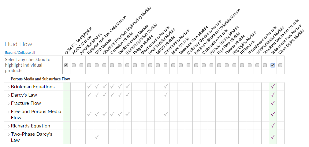

Hello Lucas,
Various COMSOL products include interfaces for modeling fluid flow in porous media, see the attached screenshot of the corresponding section of the Specification Chart (
www.comsol.com/products/specifications). The first thing I can recommend is that you check that your license includes the needed product for the type of porous media flow you want to analyze. You can check what products are included on your license by going to File > Help > Licensed and Used Products.
If/once you have the right product, you will find background theory and self-training tutorials in the documentation for the product in question and its Application Libraries.

Hello Lucas,
Various COMSOL products include interfaces for modeling fluid flow in porous media, see the attached screenshot of the corresponding section of the Specification Chart (https://www.comsol.com/products/specifications). The first thing I can recommend is that you check that your license includes the needed product for the type of porous media flow you want to analyze. You can check what products are included on your license by going to File > Help > Licensed and Used Products.
