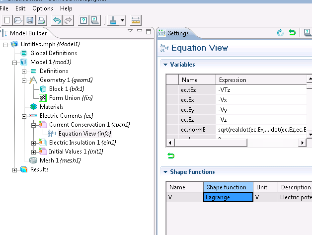

But, I even did a quick check before writing my previously response, looking at the equations under the EC/ES modules (see png) :(
and ec.normE = sqrt( realdot(Ex,Ex)^2 + realdot(Ey,Ey)^2 + realdot(Ez,Ez)^2 )
realdot() is there since Ex,y,z might be complex, as you square the variables for the norm you might get some bifurcation issues with the solver indeed
Note in the magnetic MF we have Ex = Axt or d(Ax)/dt or for MEF a combination of both EC and MF
The difference might come from the "curl" and "Lagrangian" shape elements used respectively for solving A and V as dependent variables
again note the notation:
Ax is the x component of vector A, while Vx is the x derivative of the scalar V
Axx is the x derivative of Ax the vector x component, while Vxx is the second derivative of scalar V
