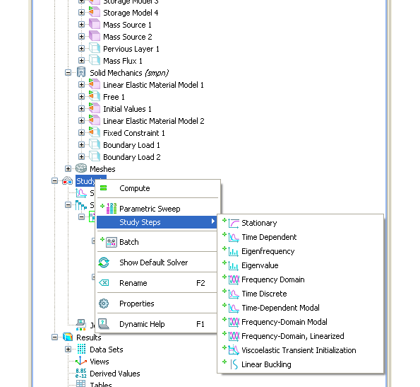

Hi!
From the documents of v 4.1,
Explicit time stepping solver using the Runge-Kutta method is now available.
But I couldn't find it in the time stepping method
Study-Study Steps? Attached is a pic shows the solvers.
I have the latested updated version.
Thanks!
XLi

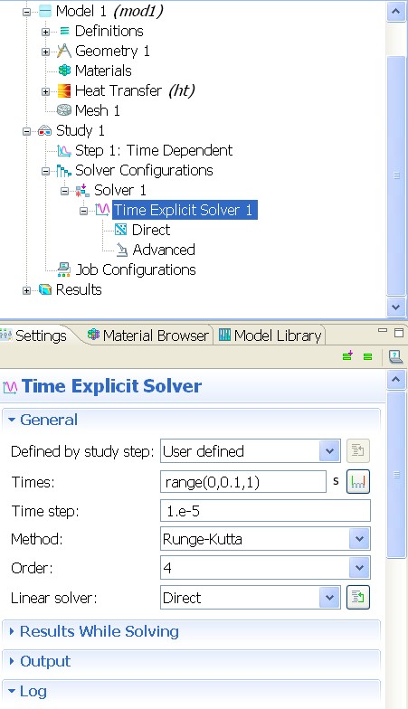

In v4.1 explicit time solver is available. Refer to the attached image.
AK
Hi, In v4.1 explicit time solver is available. Refer to the attached image. Regards, AK
