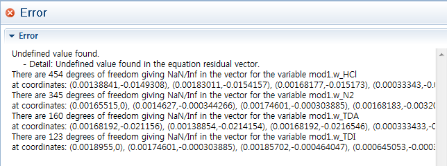

but when i choose compressible flow(Ma<0.3), i have a error
( incompressible flow is not !! it has not error )
error massage is attached. !!
