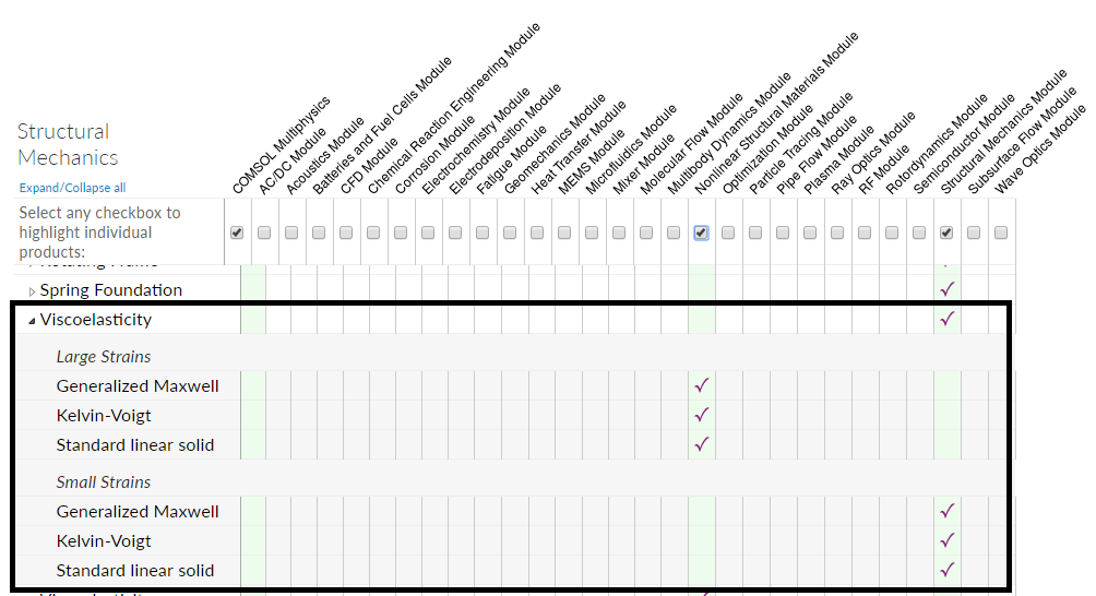

I am trying to model a volcano with viscoelastic material. But I cannot find the linear viscoelastic material mode option in my interface (solid mechanics(solid)>material mode>). I am using COMSOL 5.0. Can you help me with it.
Bhuvan.

Jeff Hiller COMSOL Employee
Posted: 8 years ago 2017年7月11日 GMT-4 14:23
Hello Bhuvan,
Viscoelastic materials are available only if your license includes the Structural Mechanics Module. They are not available among the structural mechanics capabilities of the core COMSOL Multiphysics. More options are available if your license includes both the Structural Mechanics Module and the Nonlinear Structural Materials Module. See the attached exerpt from the online product specification chart (www.comsol.com/products/specifications/),
To determine whether your license includes either of those products, go to File > Used and Licensed Products.
Best,
Jeff
Hello Bhuvan, Viscoelastic materials are available only if your license includes the Structural Mechanics Module. They are not available among the structural mechanics capabilities of the core COMSOL Multiphysics. More options are available if your license includes both the Structural Mechanics Module and the Nonlinear Structural Materials Module. See the attached exerpt from the online product specification chart (https://www.comsol.com/products/specifications/), To determine whether your license includes either of those products, go to File > Used and Licensed Products. Best, Jeff
