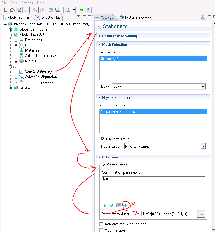

Thank you Ivar. Is this in the Study Settings, under Continuation parameter?
I really appreciate all your help!
Austin
Thank you Ivar. Is this in the Study Settings, under Continuation parameter? I really appreciate all your help! Austin
Posted: 1 decade ago 2011年3月16日 GMT-4 17:17
I would say so, take a look this is for a torque load applied in steps
Hi I would say so, take a look this is for a torque load applied in steps -- Good luck Ivar
