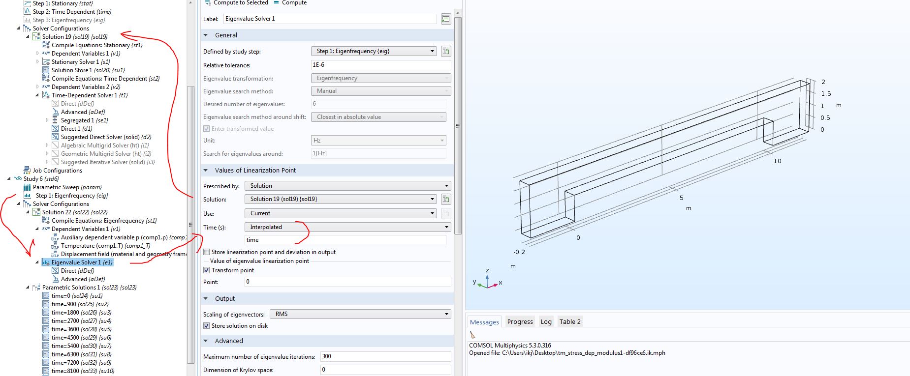

Thank you for taking a look at this. It seems like the one step that is still giving me trouble is the parametric sweep for the eigenfrequency. I am currently getting an eigenfrequency output that is identical for all solutions, regardless of what time step they represent.
I created a parameter named 'time' which sweeps across the same values as the time steps for the Time Dependent study. But from re-reading your answer, it seems like I am missing something. What do you mean when you say "interpolation indexing" into the time series via the Parametric value?
Best - Paul

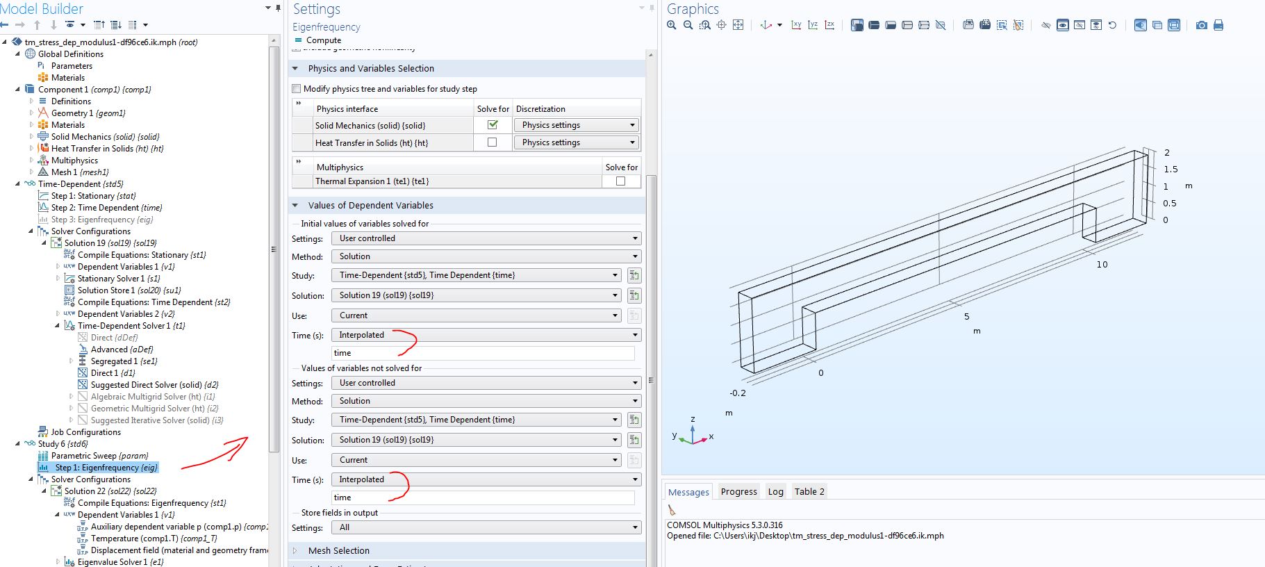

then probably its the "index" into the time solution or the "time pointer" that did not get up correctly, in both Derived variables initialisation AND in the Eigenfrequency solver node initialisation settings. see the images below, I have only the latest version of COMSOL active.
By the way your mesh is a bit coarse cehck your CFL number.
Sincerely Ivar

A big thanks for the clarification and screenshot, Ivar. This model is a placeholder for a more complex geometry that will use the same physics, so fast computation time for testing purposes was the priority instead of accuracy. I will look into CFL and study time steps as I move into my main model, since it's not something I have ever looked at very closely on other projects, although it sounds like a good practice.
