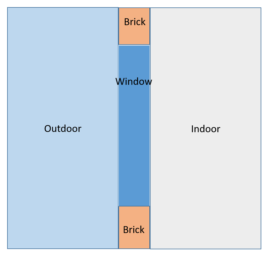

Hi, I'm wondering if there is a "simple" simulation tutorial on natural convection? What I want to simulate will be a wall with a window. On one side of the wall it will be indoor climate with room temperature and on the other side I will use a climate data as amibient temperature. So basically I have 3 regions connected to eachother, fluid connected to solid and to fluid again. Is there any tutorials that have similair layout to this case? I have attached my case, it's also in 2D.
Best regards, Arman

I suppose you already gave those models a look?
link
Maybe this post can guide you further?
https://www.comsol.com/blogs/thermal-modeling-of-the-air-flow-inside-and-around-your-house/
Best, Tobias
Hi, I suppose you already gave those models a look? [link](https://www.comsol.com/models/?q=natural+convection) Maybe this post can guide you further? [https://www.comsol.com/blogs/thermal-modeling-of-the-air-flow-inside-and-around-your-house/](http://www.comsol.com/blogs/thermal-modeling-of-the-air-flow-inside-and-around-your-house/) Best, Tobias
