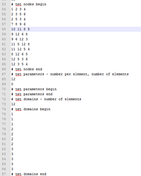

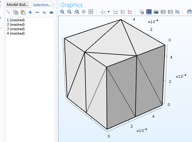

Comsol creates more domains than that defined in mphtxt
I am trying to select the domains using matlab code.
I create a mphtxt file which has 3 domains from external software but when I import this mphtxt file to COMSOL, I get 4 domains in the selection lists.
Or are there any other methods could select the domians in Comsol consistent with the number of domains in mphtxt?

In Comsol, we require mesh domains to be connected. That means, you must be able to walk between every pair of elements in a domain by passing from one element to another over a shared surface.
In the mesh file that you have attached, domain 2 consists of two connected parts. It is defined as follows:
7 8 9 6 # tetrahedron 4
10 11 8 5 # tetrahedron 5
9 12 6 8 # tetrahedron 6
9 6 12 3 # tetrahedron 7
Tetrahedra 4, 5 and 7 are connected to each other, while tetrahedron 5 is not connected to the others. Hence, Comsol splits domain 2 into two domains, assigning the unconnected tetrahedron 5 to a new domain.
We understand that this might be a problem if you want to use your original domain 2 in e.g. a physics interface. Then you need to select both domain 2 and domain 4. Which is not that complicated in this simple case, but could be hard in a complicated case where the original domain would be split into many domains.
