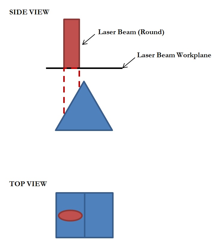

The final goal is to move a delimiting edge (the laser beam) over oblique or complex-shaped geometries.
Precedent study shows great accuracy of modeling a laser beam over a flat surface, now I want to do the same over an oblique surface (relative to beam incident plane) .
So, imagine a workplane on which is drawn a circle. Then I want to project that circle over an oblique face of a 3D object.
Thus the projected circle will then come as an ellipse on the oblique face.
(See attachement for more clarity)

if its a HT model you want, cant you make your laser beamrotate along a circle w.r.t. a user coordinate frame, and then parametrise the position of the cylindrical coordinate frame. ? OK you need to get the Z coordinate location by a projection, of you want only a surface interaction.

Yes, I want the surface of interaction, defined by a circle projected on an oblique surface. (turning out into an ellipse on the oblique surface).
On CAD software like Solidworks it is really easy to achieve this.

unfortunately the internal CAD version of COMSOL cannot "project" and create a new obbject (apart show/visualise the projection)
