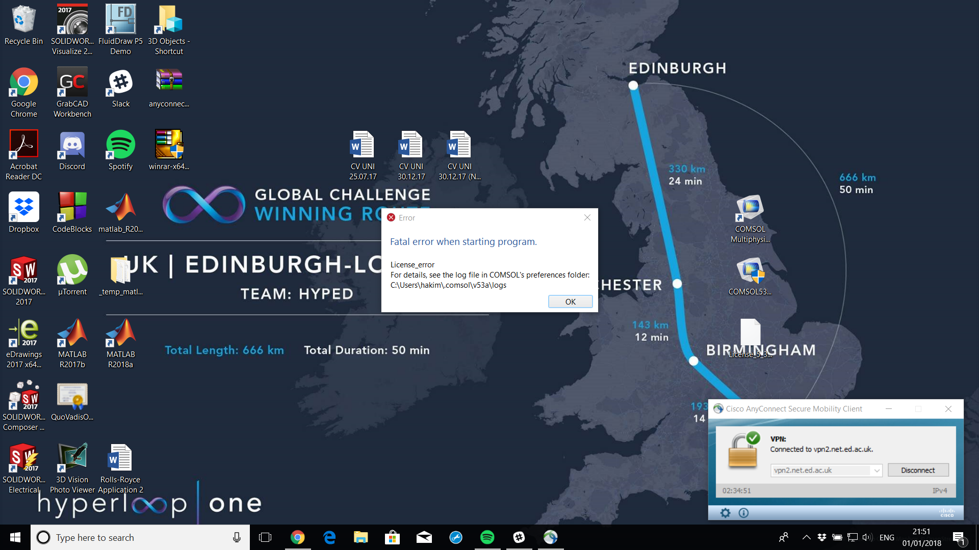

Hello Abdul Hakim,

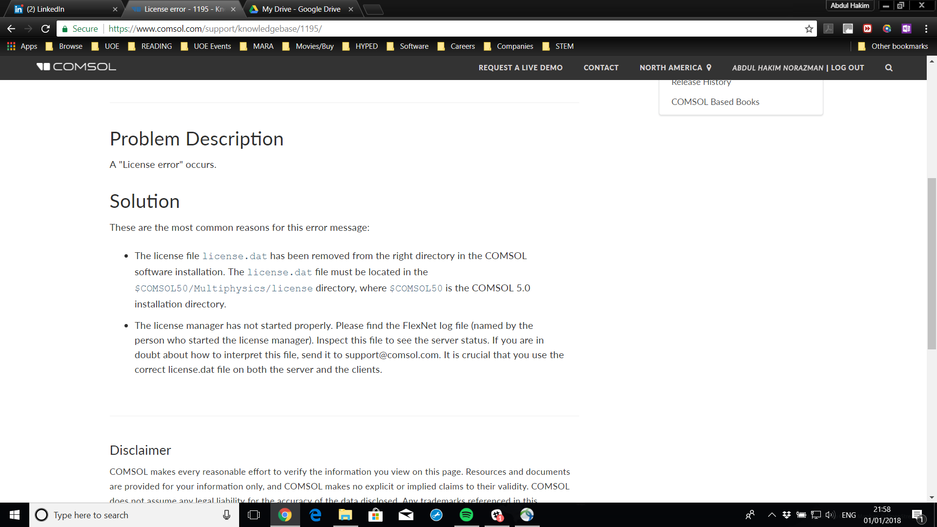

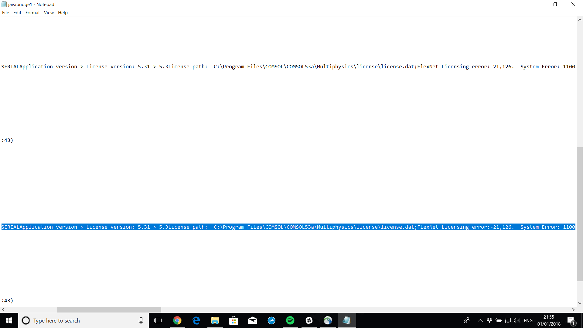

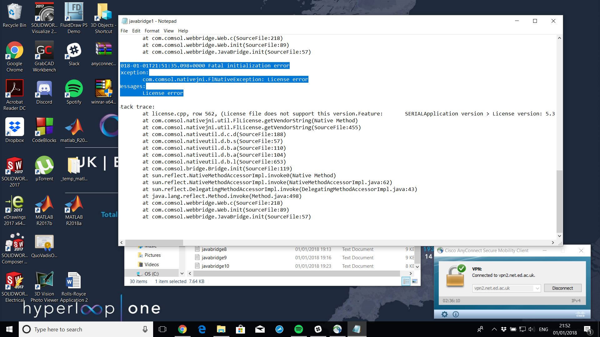

The error messages suggest that you are trying to install version 5.3a with a version 5.3 license.dat file. Make sure to use the version 5.3a file that was sent to the point of contact of record for your license.
On a networked license, the license file needs to be updated both on the clients and on the license server.
