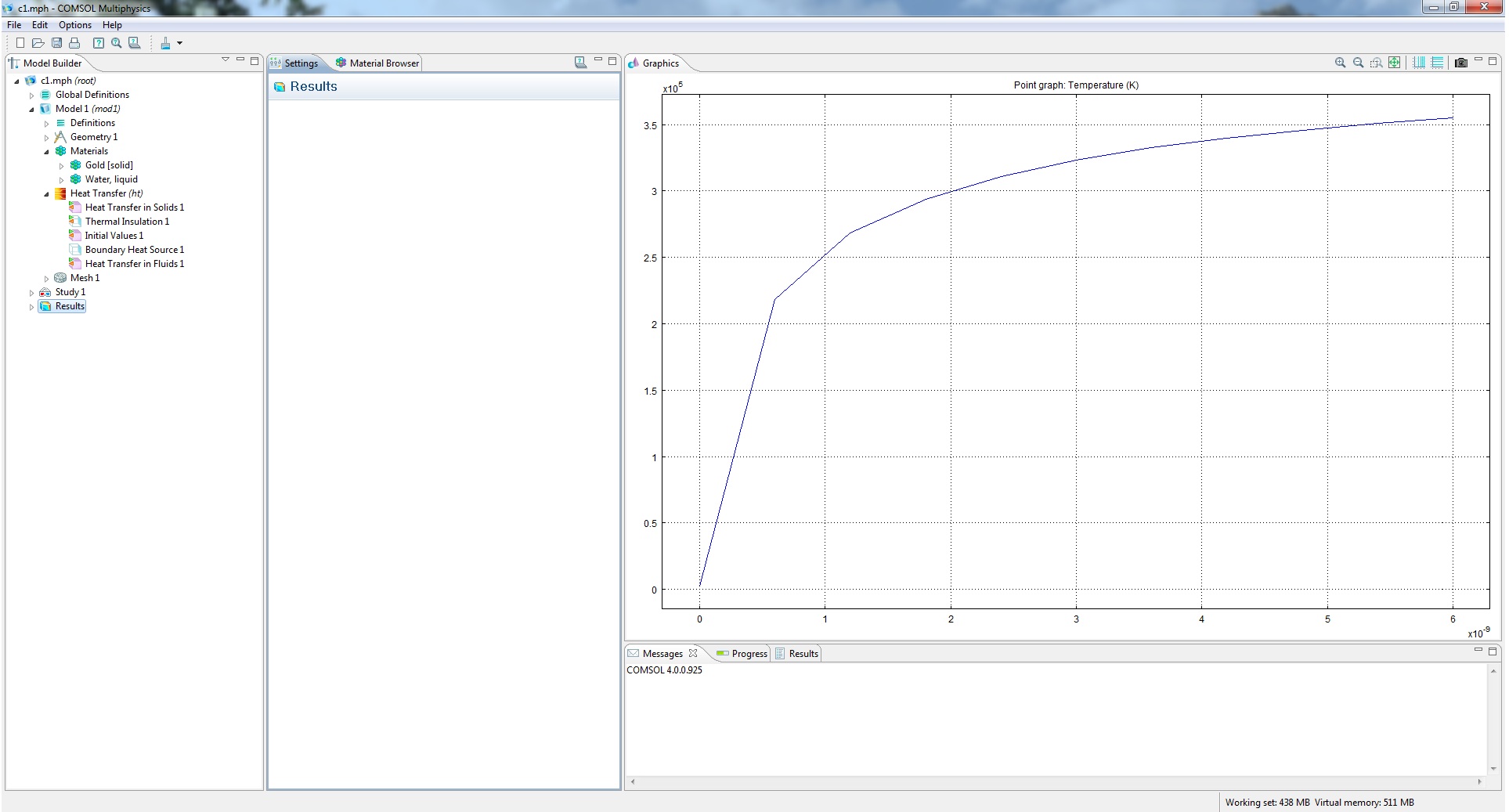

Thanks a lot for your input, they really pushed me forward in my simulation progress. Unfortunately, I think I may have hit another bump in the road. I am currently trying to model a
21-nm-diameter gold particle in water
irradiated by a 6-nsec 0.13-J/cm2 laser pulse at 532 nm.
The laser has a 4 mm radius and the pulse is Gaussian.
The Gold particle has absorbance of k=4.01
My model consists of two concentric spheres. The outer sphere is water and the inner sphere is a gold particle.
I made the gold sphere boundaries the heat source and given the information above, I calculated an average incident intensity over the 6 ns to be
24.2 TW/m^2
I calculated the average value of the gaussian pulse over two standard deviations (95%) instead of multiplying the pulse by the laser intensity because I was having issues with the units when I tried
gp1*Intensity[TW/m^2]
Initial Temperatures: 293.15[K]
Surface radiosity: 0 (not sure what value to put for this one)
These are the only boundary conditions I have.
I ran the simulation and obtained results in the 350,000 K region as you can see in the picture I provided. The values obtained experimentally were 1500 K so I am way off.
Am I still missing something in my model? I have not yet added the convection process but would this be enough to drop the temperature by 2 orders of magnitude?
Sorry for asking such a large question. Heat transfer problems are not my specialty but this is a class assignment.

Posted: 1 decade ago 2011年4月10日 GMT+8 17:56
the radiosity is for radiative exchange, normally at a few hundred degrees of temperature difference the radiative emission of a body is relevant, so you might need to consider it, at least as an exercise. Because I'm not sure for your small sizes the scaling law would make radiative exchange so important. To be checked. Use the blackbody Stephan Boltzman law, i.e. as described here
en.wikipedia.org/wiki/Stefan–Boltzmann_law
Do not forget that it uses the difference in temperature in Kelvin ;) and with a T^4 relation it is very non linear

Posted: 1 decade ago 2011年4月11日 GMT+8 01:53
Once again, thanks for your input.
When I tried to add in BB Radiation, I got the following error message:
Failed to evaluate variable Jacobian.
- Variable: mat.epsilon rad
- Geometry: 1
- Boundary: 5 6 7 8 11 12 14 15
These are the boundaries of my gold sphere. From what I can interpret there's a missing material property but I filled in Surface Emissivity for gold already and added it and I still got the same error.
Once again, thanks for your input. When I tried to add in BB Radiation, I got the following error message: Failed to evaluate variable Jacobian. - Variable: mat.epsilon rad - Geometry: 1 - Boundary: 5 6 7 8 11 12 14 15 These are the boundaries of my gold sphere. From what I can interpret there's a missing material property but I filled in Surface Emissivity for gold already and added it and I still got the same error.
Posted: 1 decade ago 2011年4月11日 GMT+8 05:44
it could be a version issue, try it on a newer v4.1 latest patch, it should work OK
Hi it could be a version issue, try it on a newer v4.1 latest patch, it should work OK -- Good luck Ivar
Posted: 1 decade ago 2011年4月11日 GMT+8 06:19
I was able to fix that issue by just changing to "user-defined" emissivity rather than changing the actual material property.
The drop in temperature was significant, it dropped by 2 fold. Now my max temperature is 1.4 x10^5. Still two orders or magnitude too high.
I will now try to add in convective cooling and see how that goes.
Thanks.
Hi, I was able to fix that issue by just changing to "user-defined" emissivity rather than changing the actual material property. The drop in temperature was significant, it dropped by 2 fold. Now my max temperature is 1.4 x10^5. Still two orders or magnitude too high. I will now try to add in convective cooling and see how that goes. Thanks.
Posted: 1 decade ago 2011年4月11日 GMT+8 13:42
convection is normally a few W/m^2/K I'm not sure that will give you a big difference, because of your small scale, but always worth to try. Often its also useful to do some hand calculations to get the orders of magnitude
Hi convection is normally a few W/m^2/K I'm not sure that will give you a big difference, because of your small scale, but always worth to try. Often its also useful to do some hand calculations to get the orders of magnitude -- Good luck Ivar
Posted: 1 decade ago 2011年4月12日 GMT+8 23:03
Thanks a lot for your input. I was able to get the model very close to experimental data. You are right, adding in convection barely changes the temperature distributions.
It turns out I had made an error in the units, causing my input intensity to be 7 magnitudes off.
