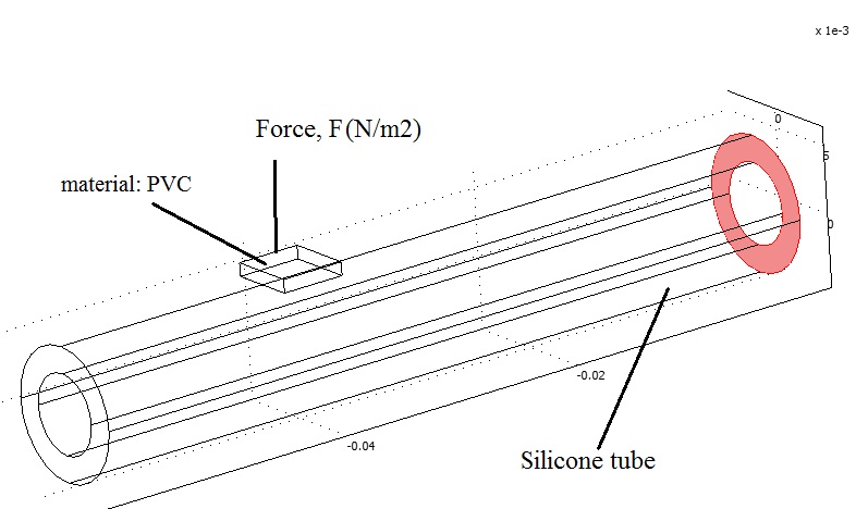

Deformation on a flexible tube
I would like to analyze the deformation of a silicone tube when an applied force "F" on a square piece located at the top of the pipe (see figure). What modules of the Comsol should I use ?

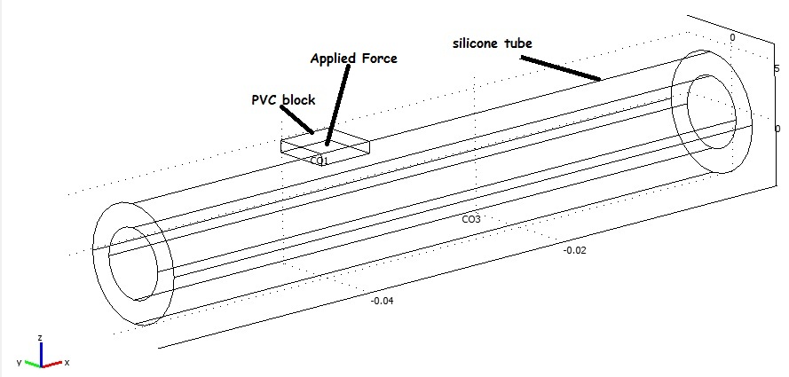

Hello everybody,
I would like to apply a force on the block of PVC and calculate the volume of the silicone tube varied due to compression. I'm using the module Solid-Stress-Strain (sld) = subdmain 1 is the silicon tube, subdmain 2 is PVC.
How do I check the deformation experienced by the tube due PVC block?

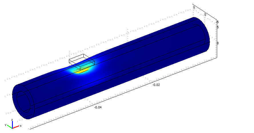

The block of PVC seems warped, but the tube nothing happens. I believe this is wrong.
How do I calculate the volume? use the integration of subdomain? What is the variable of integration?
I would like to see the silicone tube being deformed by the block of rigid PVC.
Thanks a lot
The block of PVC seems warped, but the tube nothing happens. I believe this is wrong. How do I calculate the volume? use the integration of subdomain? What is the variable of integration? I would like to see the silicone tube being deformed by the block of rigid PVC. Thanks a lot
Posted: 1 decade ago 2011年5月12日 GMT+8 00:14
I see what you have defined on the boundary loads ! That looks correct, but perhaps it's not what you wanted ;)
If you take the third-last image, there you FREE the lateral sides along "z" of your square pushing block you might see a far more important squeeze, since then the block may slide freely
What you see on the last image is the pushing bloc, with the lateral sides fixed, being bend by the applied load/pressure
Hi I see what you have defined on the boundary loads ! That looks correct, but perhaps it's not what you wanted ;) If you take the third-last image, there you FREE the lateral sides along "z" of your square pushing block you might see a far more important squeeze, since then the block may slide freely What you see on the last image is the pushing bloc, with the lateral sides fixed, being bend by the applied load/pressure -- Good luck Ivar

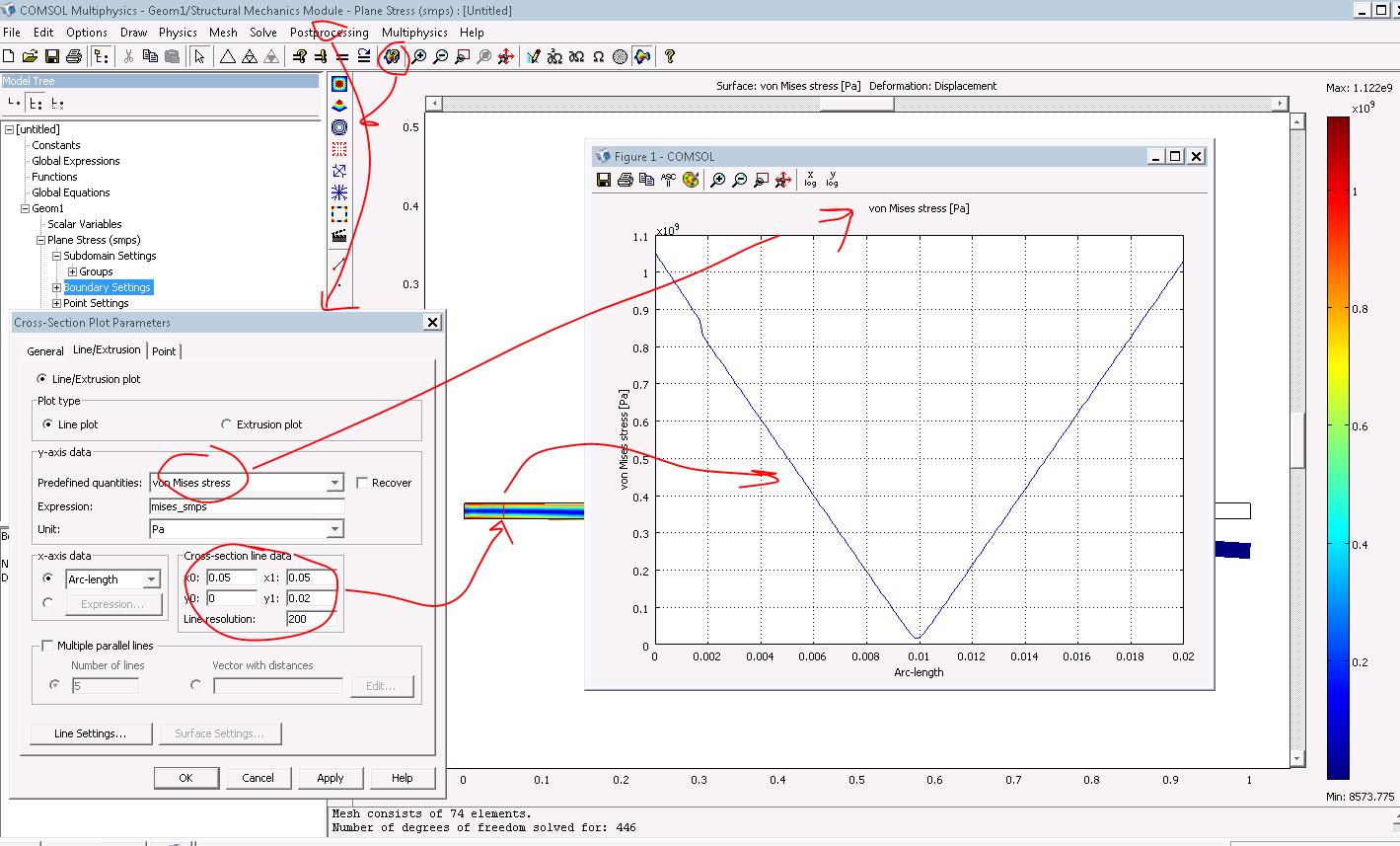

Posted: 1 decade ago 2011年5月13日 GMT+8 13:09
in V4, add a Data set cut plane (they exist in v3.5 too), or what I do often is to cut my volume and add a "metrology purpouse" internal boundary, when I make the CAD geometry
Hi in V4, add a Data set cut plane (they exist in v3.5 too), or what I do often is to cut my volume and add a "metrology purpouse" internal boundary, when I make the CAD geometry -- Good luck Ivar
Posted: 1 decade ago 2011年5月13日 GMT+8 19:59
Hello Ivar,
I´ve never done it. Could you send me an example or a tutorial on how to do this ?
Thanks a lot.
Hello Ivar, I´ve never done it. Could you send me an example or a tutorial on how to do this ? Thanks a lot.
Posted: 1 decade ago 2011年5月14日 GMT+8 16:35
that you should be able too, it is getting "old" and unfamiliar for me as I have left 3.5 behind for some time now ;)
take a look
Hi that you should be able too, it is getting "old" and unfamiliar for me as I have left 3.5 behind for some time now ;) take a look -- Good luck Ivar
