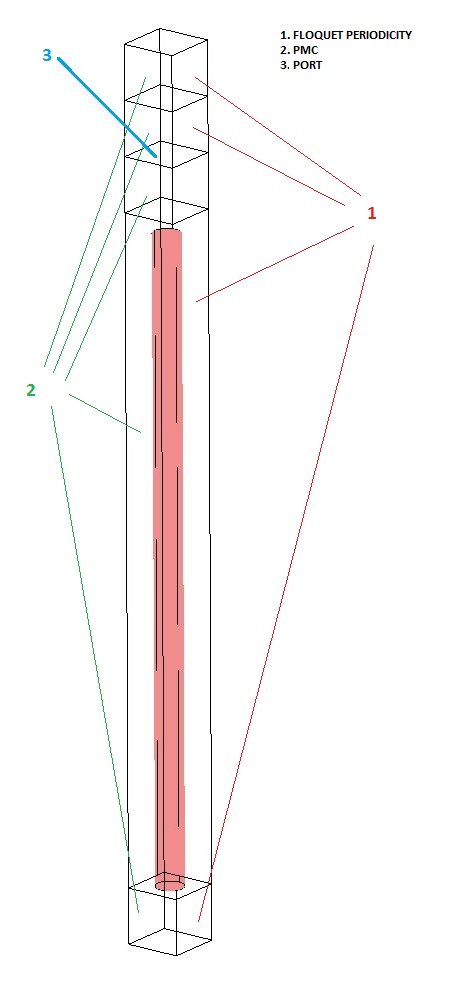

the problem consists in measuring the absorption of radiation in a silicon nanowire. The incident electromagnetic wave reaches the nanowire (a cylinder in the figure) with "k" parallel to the axis of the cylinder. The wave is TM.
The figure shows the modeling of the problem: a solid silicon cylinder surrounded by air where the "air cubes" at the ends of the figure are Cartesian PMLS. My question is: taking advantage of the symmetrical geometry, How can I get the same results using only one fourth of the actual geometry? How do I do with the boundary conditions? Should I maintain the same boundary conditions? How should these boundary conditions be applied?
