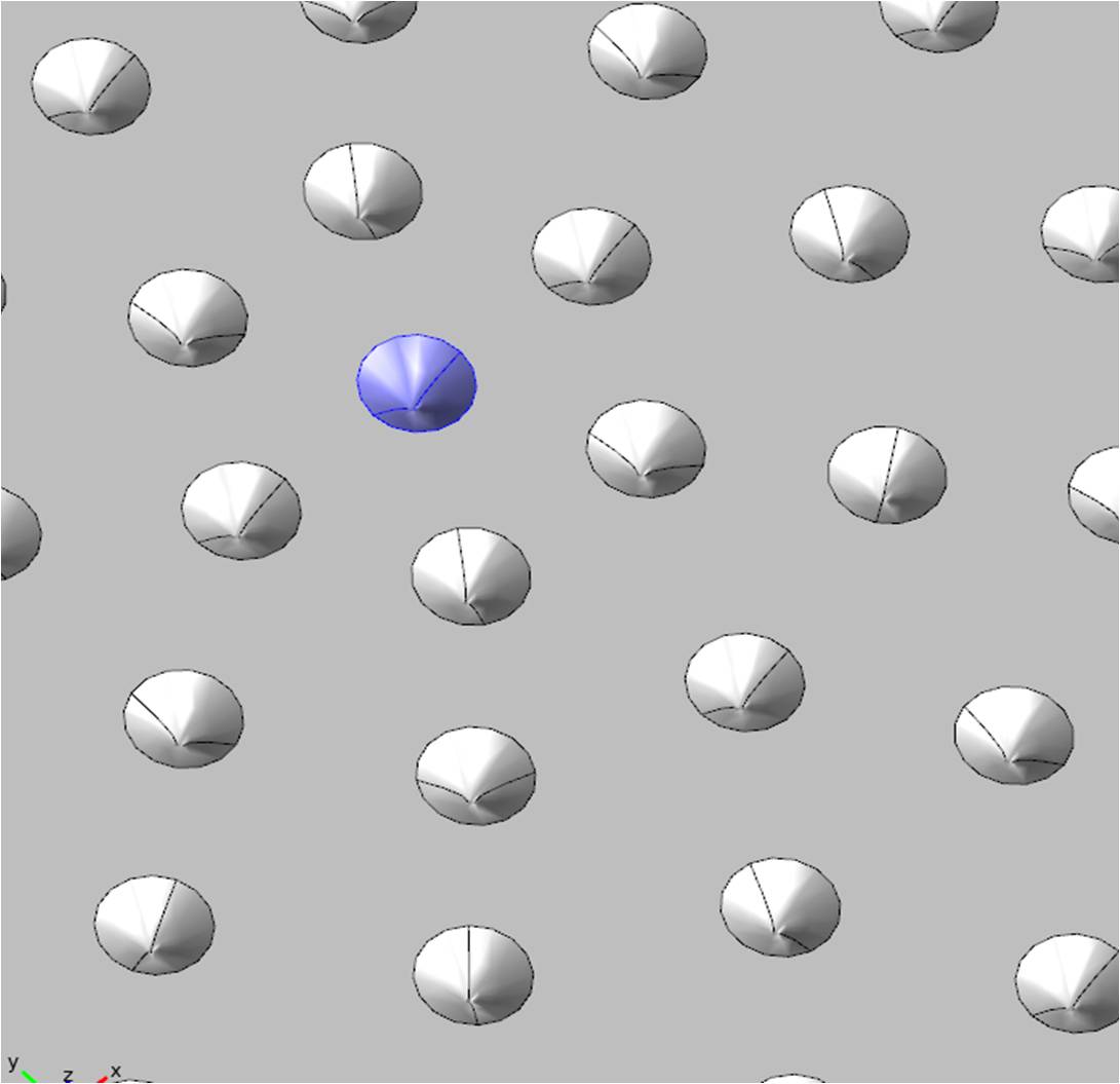

I have a solid mechanics model and a pressure load. I have holes in my model and would like to see how the volume of these holes change over my time dependent loading. I would like to find the volume of the pictured hole for each step/load/time in my solution.

As you have a repetitive pattern, I would attach such a model by studying only one item with periodic boundary conditions. This for the hole volume change, if you want the overall deflection of your corregulated membrane you need a larger 3D or adapted shell model. Models for uch structured "shells" or thin membranes (typical for MEMS applications) are missing from COMSOL, at least as pre-cooked BC's you must build and validate them via equations yourself, still
