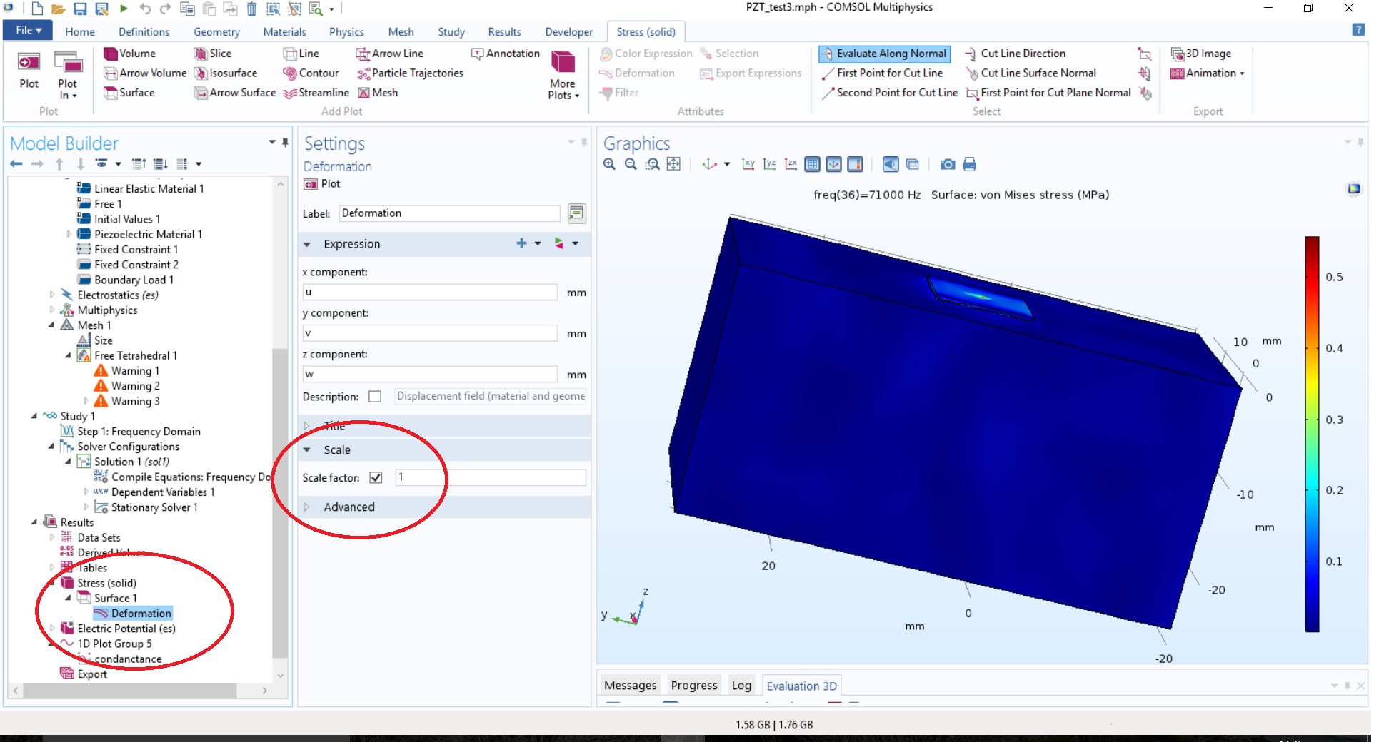

Results-->Stress-->Surface 1-->Deformation-->You will find Scale over there. Just change the scale factor to 1. :)
