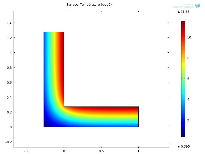

I am simulating a simple concrete wall junction and i've created a temperature difference between the exterior and the interior.
Now I need the total heat flux passing from the interior to the exterior, I am only able to visualise the progress the heat flux through the wall, but I need the value of the heat flux passing through it. Can anyone help me?

Actually the equations are right and I am getting coherent results but I need to find the total heat flux and this I can't figure out how to do this, in the 3.5 version there is the post treatment where you can get the values of the heat flux passing through any surface you want but how can I do the same thing in the 4.0 version?

I do not have 4.0, but here is an example in 4.1
You need ti integrate the normal heat flux. But for good/best results, you should set the fixed temperature boundaries to "use Weak form". Then in the Solver Enable "Direct mode" (requires more ram than an iterative solver). And integrate "T_lm" over the boundary. T_lm (the lagrange multipliers) is given without units, but in HT its W/m^2 see the doc
Check also the page on the KB about heat fluxes
