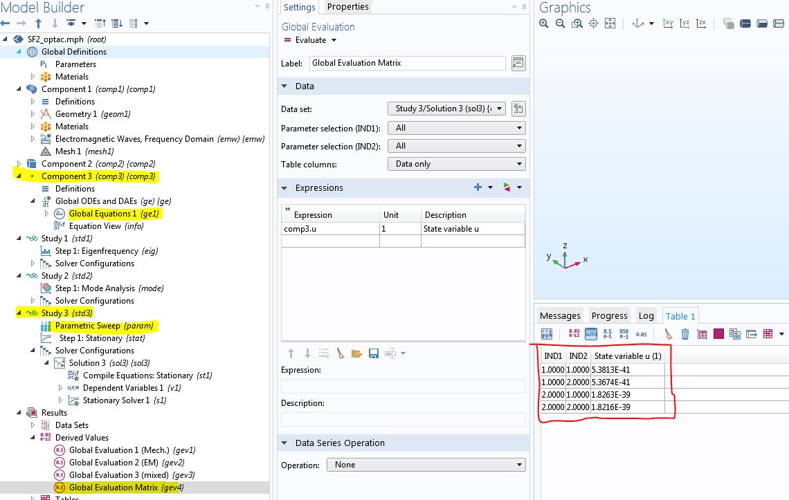

Comsol support team helped me to find the solution to my problem. I will post it here in hope that it will help other people.
The solution is to create a new study sweeping over the acoustic and optical mode number named IND1 and IND2 respectively and to access the different mode parameters by using 'withsol' operator together with 'setind' in a global ODE placed in a new 0D component:
u-(withsol('sol1',comp2.solid.Wh_tot,setind(lambda,IND1))*withsol('sol2',comp1.emw.intWe,setind(lambda,IND2))).
Note that 'withsol' also works with geometry-dependent variables. See the attached screenshot and corrected example.
Comsol support team helped me to find the solution to my problem. I will post it here in hope that it will help other people. The solution is to create a new study sweeping over the acoustic and optical mode number named IND1 and IND2 respectively and to access the different mode parameters by using 'withsol' operator together with 'setind' in a global ODE placed in a new 0D component: u-(withsol('sol1',comp2.solid.Wh_tot,setind(lambda,IND1))*withsol('sol2',comp1.emw.intWe,setind(lambda,IND2))). Note that 'withsol' also works with geometry-dependent variables. See the attached screenshot and corrected example.
