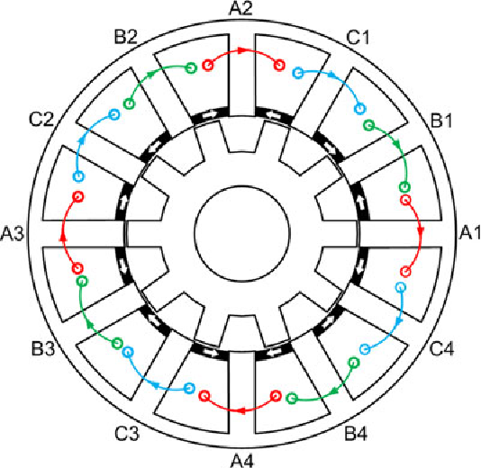

Hello, I'm modeling a Brushless AC Doubly Salient Stator Slot Permanent Magnet Generator, as in the figure that is attached. How do I make the controller or sync the currents to make the machine work as a generator in the comsol? Anyone could help me?

To make a different current waveforms, I would recommend to use the "Functions-> Analytic/Periodic/PieceWise" or a combination of these functions to get a input current waveforms for each phases.

Hi nirma, Thanks a lot for reply. Do you have any example that I can use to guide me?
