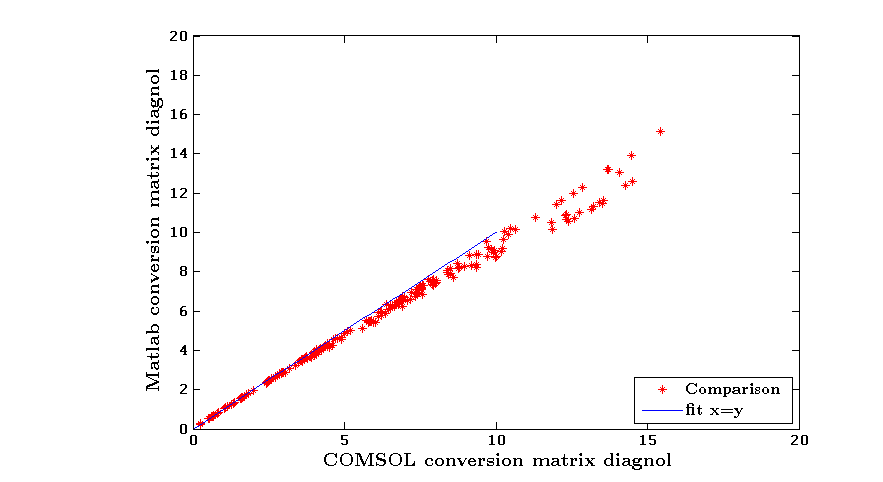

I have an expresion I need to integrate. I have been integrating this expression in MATLAB. However I find that when I integrate the same expression in COMSOL I get a slightly different value (see image).
In COMSOL I calculate
FF = solid.freq*2*pi/2/(solid.Ws_tot)/solid.rho*d(solid.Ws,T), and
Cii = volume integral of { solid.rho*solid.freq*2*pi/2/(solid.Ws_tot)/solid.rho*d(solid.Ws,T)*solid.freq*2*pi/2/(solid.Ws_tot)/solid.rho*d(solid.Ws,T) }
and in MATLAB I calculate
Cii(i) = sum ( rho * meshvol .* FF(:,i) .* FF(:,i) );
where meshvol, rho and FF are those exported from COMSOL and i indexes eigenmodes.
Is there a method to get identical results?
