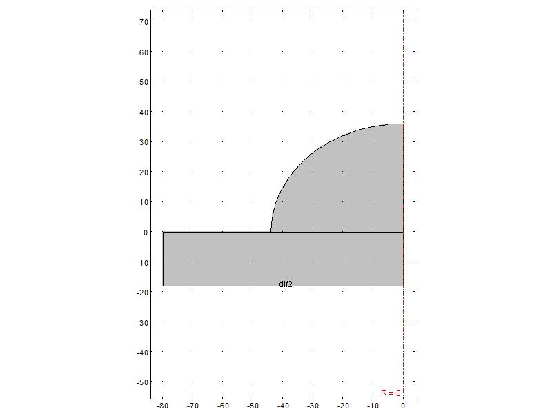

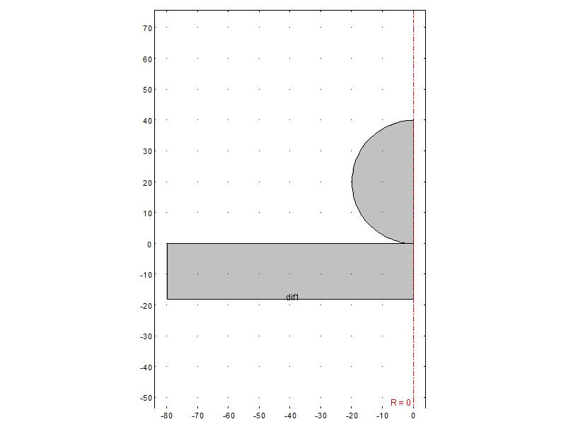

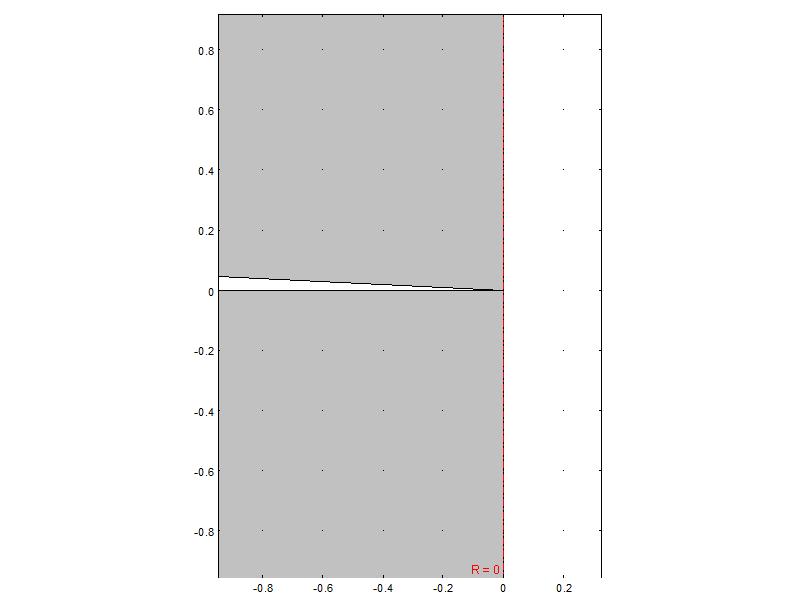

Hi, I´m trying to model a concact mechanic proble with COMSOL 4.1.
The initial geometry consists on a circle that lies on a rectangle (therefore the concact between the two surfaces is a point) . The circle is much softer that the substratum and tends to bind it (with a certain force). I would like to define an area that sorrounds the boundary of the sphere and the substratum in such a way that all the points that belong to this area become in contact with the force mentioned above.
I attached three files:
1) in the first one you have the geometry that I want to start with.
2) in the second one you have a snapshot that wants just to point out that the initial concact beetween the surfaces is just a point.
3) the third one is approximately what I expect as a solution.
