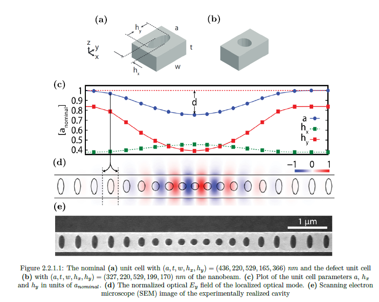

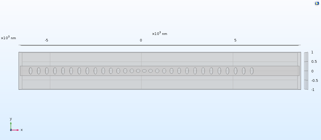

I am trying to study the evanescent field around a nanophotonic cavity. My structure is very similar to the one from Painter group for the ones who know his work (see painterbis.png). I reproduce his structure as an example here for my question : see 01.png. The structure is in Silicon with a box of air all around (1 micrometer) and scattering boundary conditions all around.

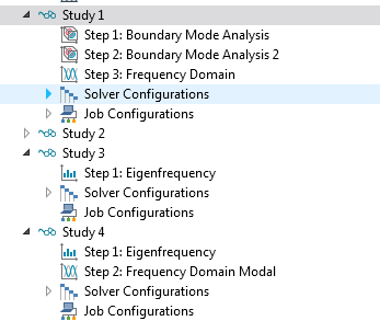

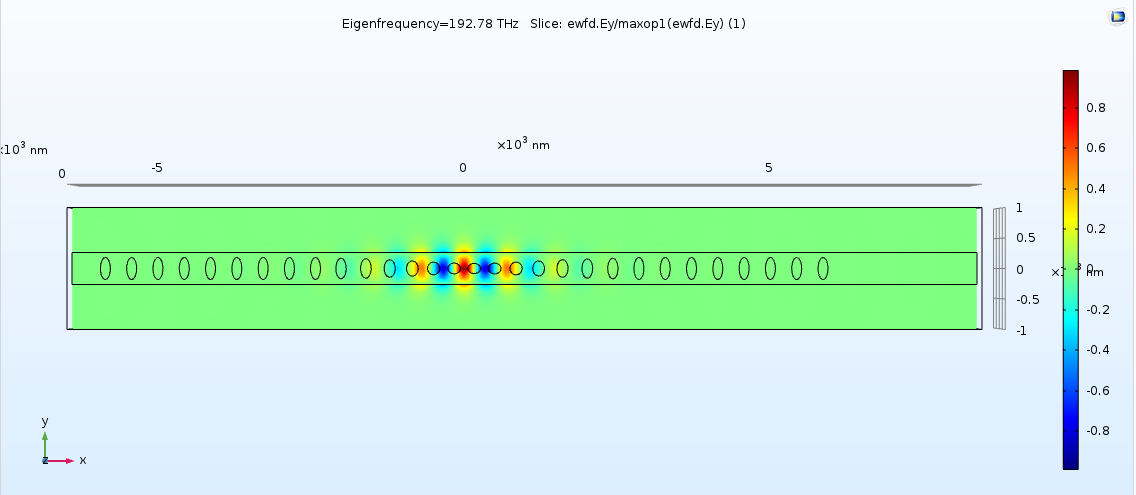

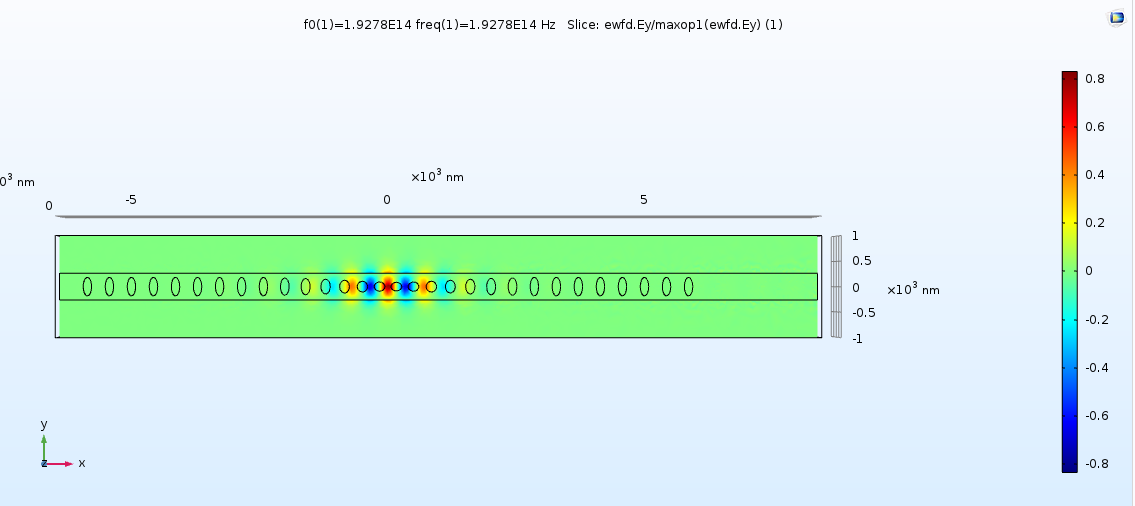

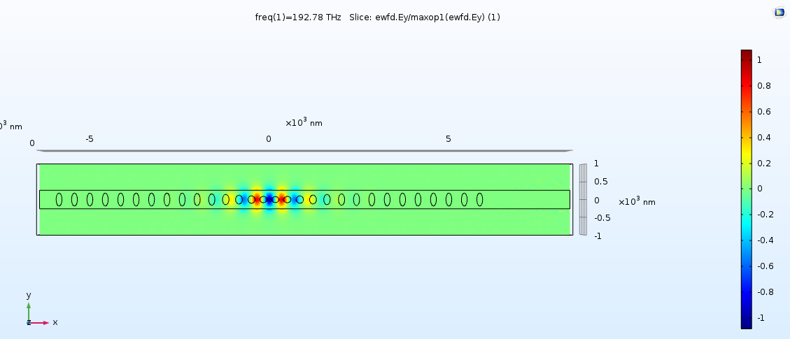

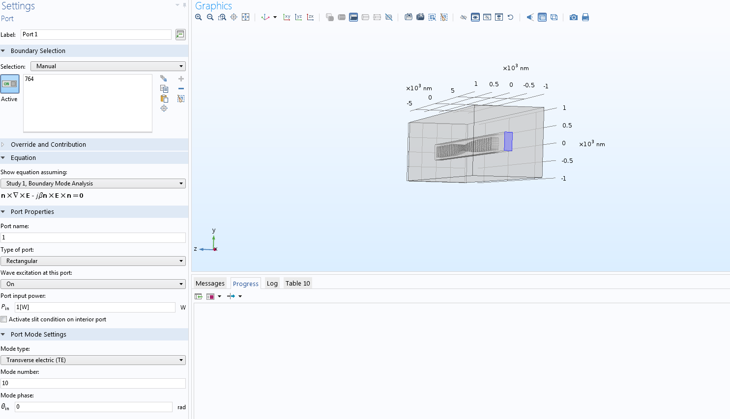

I did 2 steps : - find the resonance mode : with an eigenfrequency study, it works perfectly : see 03.png - With this frequency as an input, I did a frequency domain study (see 10.png : I added a port (one ON sendind a TE10 mode and one OFF) on each side of the cavity, hence I added 2 steps for the study : boundary mode step). For this one frequency, I get 05.png so the right result (I am plotting ewfd.Ey each time) - you can notice that with the frequency domain modal study I get the same : see 11.png

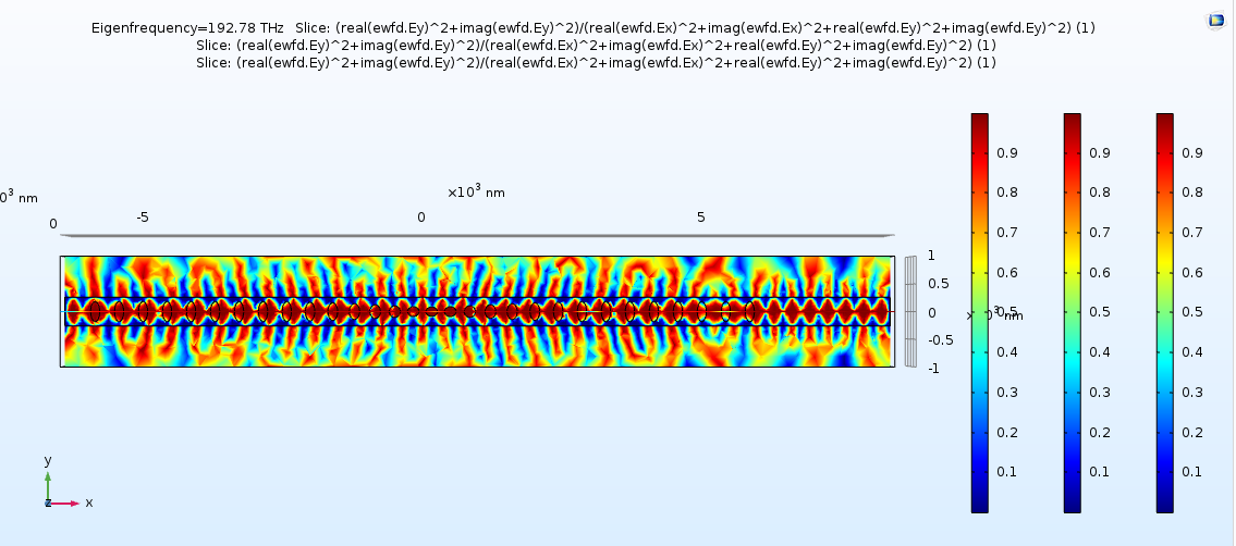

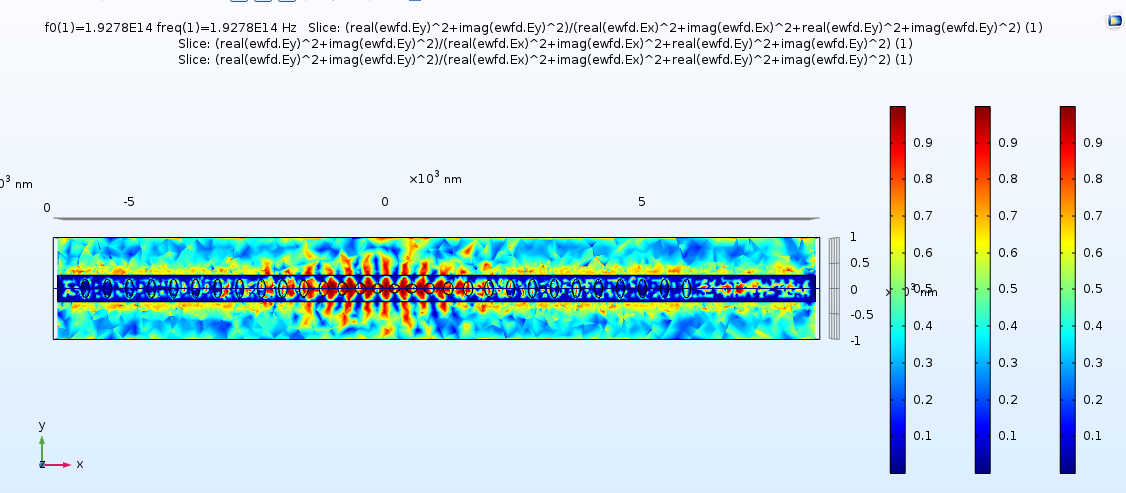

Then, if I look at another quantity, that is to say the phase or here the quantity |Ey|^2/( |Ey|^2+ |Ex|^2), which is just a projection of the field on the vector (0 1).T : if this quantity is equal to 1, the field is linearly polarized, if it not equal to 1 the polarization is elliptic. Here is my problem :
With the result of the eingenfrequency study, when I plot this quantity for the mode found just before, I get 04.png. You can see that there is a lot of red and it seems kinda smooth and nice. With the result of the frequency domain study I get 09.png. My question is : why is it so different ?
