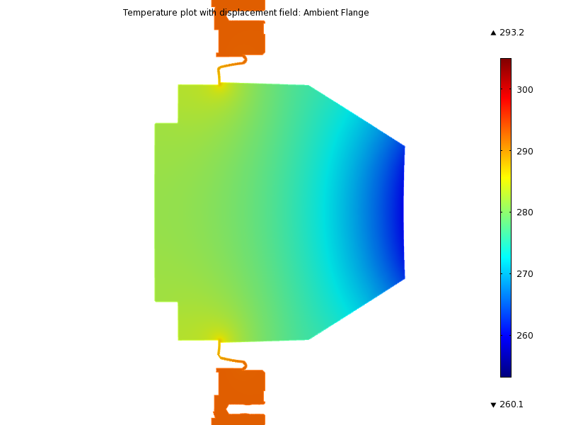

Hi, I have a 3D model which I have completed a heat transfer analysis upon. It is a vacuum flange/optical taper/expansion ring assembly.
The expansion ring provides flexure to accommodate differential thermal expansion between the stainless steel flange and the fiber optic taper. One end of the taper is held at a constant flux corresponding to ~-20C while the rest of the body is initially at ambient. I have attached a slice from the 3D model showing the temperature distribution and deflection (500X scale). You can see the X-section of the expansion ring and the exaggerated flexure.
Next I wished to estimate the deflection of the expansion ring and taper as the pressure is reduce on the vacuum side. It will be at ultra high vacuum (i.e., 10E-9 Torr) and the negative pressure will "pull" upon all the exposed surfaces due to the vacuum. This is what I wish to model.
