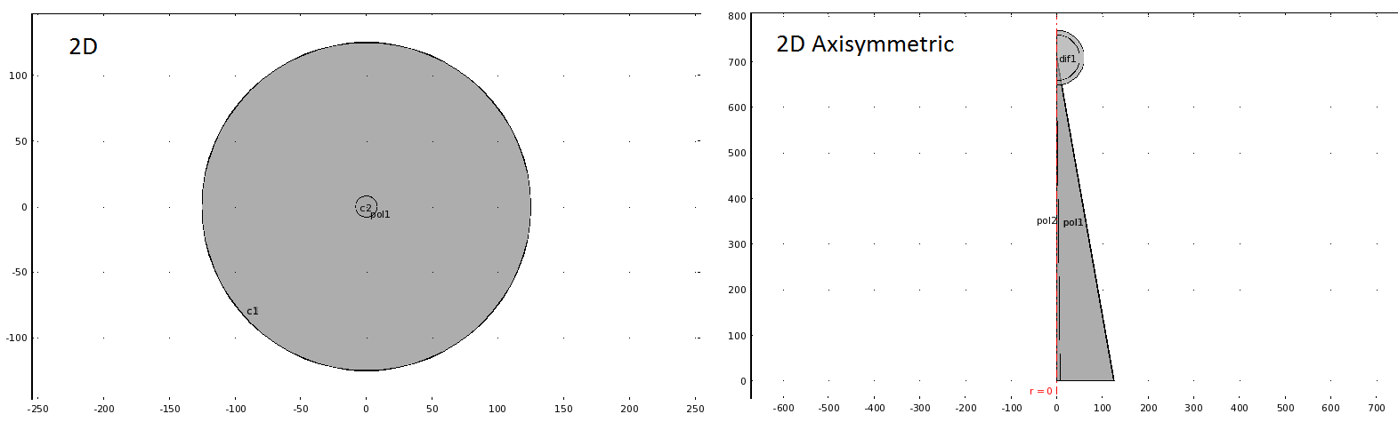

Dear Ivar,
Apologies for not phrasing the problem clearly and thanks for your fast reply! In the regular 2d case I study a circle that should have the same dimensions as the the port that I defined as a line from r=0 in the 2D axisymmetric case (if I unstand the 2D axisymmetry correcly).
Do I not correctly assume that applying a mode analysis to the regular 2D circle should yield the same effective mode index as the a boundary mode analysis to this 'line' from r=0 in the 2D axisymmetric case?
Boris
Dear Ivar, Apologies for not phrasing the problem clearly and thanks for your fast reply! In the regular 2d case I study a circle that should have the same dimensions as the the port that I defined as a line from r=0 in the 2D axisymmetric case (if I unstand the 2D axisymmetry correcly). Do I not correctly assume that applying a mode analysis to the regular 2D circle should yield the same effective mode index as the a boundary mode analysis to this 'line' from r=0 in the 2D axisymmetric case? Boris
Posted: 1 decade ago 2011年5月23日 GMT-4 10:19
For clarity, these are the geometries I use (in the 2D axisymmetric case my port is at z=0)
Posted: 1 decade ago 2012年2月28日 GMT-5 06:31
Shouldn't the 'dif' half circles on the top of your 2D-axi actually be rectangle-shaped? Because this revolves around the r=0 axis and the circular fiber profile would be created automatically...
