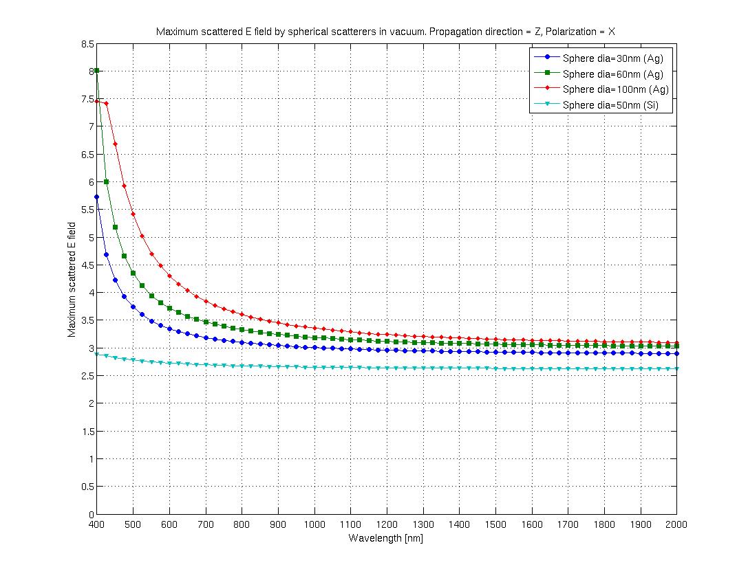

as a Comsol beginner I'm having some difficulty in calculating the scattered field of nanoparticles.
I'm trying to find out the scattered field of nanospheres having dia 30nm-100nm, cubes and ellipsoides with almost similar dimensions and am using a rectangular computational domain with rectangular PMLs and get them solved for a number of wavelengths
My Comsol-Matlab interface is not working and that's why I convert Postprocessing (coordinates data) data into Ascii files and try to process them. I get x,y,z and data for each wavelength. I read in the ascii file
%x y z (normE_rfw)[1/(V/m)] wavel(5)=5e-7 ...
As far as I know normE means sqrt(E.E*). This doesn't seem to be the scattered field that should've been calculated by Comsol.
Am I solving the model wrong or exporting the wrong variable?
How to plot my results in the way Xia has done in the appended fig. where we see optical coefficient vs wavelength?
I've tried to calculate the maximum values of the field (which I thought to be scattered field) and have plotted it for different particles in matlab.
Many thanks for your suggestions.
