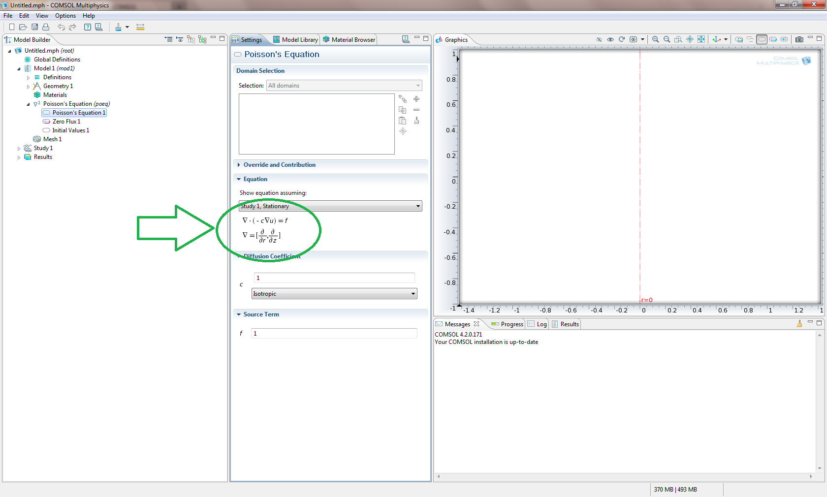

as a new user I am quite disappointed:
The geometry of the model can be defined as 2D axisymmetric, but when I add the PDE for Poissons equation to it (via PDE (poeq), the equation is not adapted to the geometry?
Which coordinate system is used in the equation? On the drawing/Geometry r and z is used, but it is not clear to me whether the equation is based on a cartesian system x,y,z , or on r,phi,z ?
How is the div (divergence) operator in cartesian and axisymmetric coordinates written in Comsol?

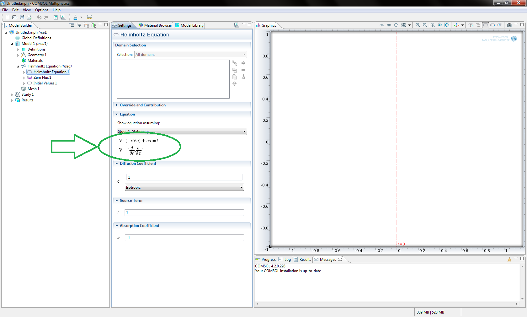

also as new user, who wasted several weeks now with on false 2D axisymmetric models, I must add that this is far more than dissapointing.
In my opinion it is by far not obvious for the common user that the program uses a different coordinate system internally than defined by the geometry. BTW: at least in the case of the Helmholtz equation the front end does not even show its internal definition of the nabla operator.
I must say, that I thought of comsol multiphysics as a really great piece of software. I mean, the front end, the live links to other programs and its huge spectrum of functionality are really convincing.
Now I must regretfully and painfully learn, that over quite some time all my calculations were complete nonsense.
It is totaly incomprehensible, why the mathematics models are not correctly implemented.
I strongly suggest to correct this flaw in future releases, because it is a completely unnecessary drawback of your otherwise fine software.
cheers,
jan
P.S: It is also not straight forward (at least for me) to manually correct for the missing terms.
I suspect you are running an outdated version of the software. In the current version, the definition of \nabla is displayed when solving the Helmholtz equation using the Mathematics interface; see attached screenshot.
Jeff
thanks. I was running 4.1, which indeed does not come about with this helpful hint.
