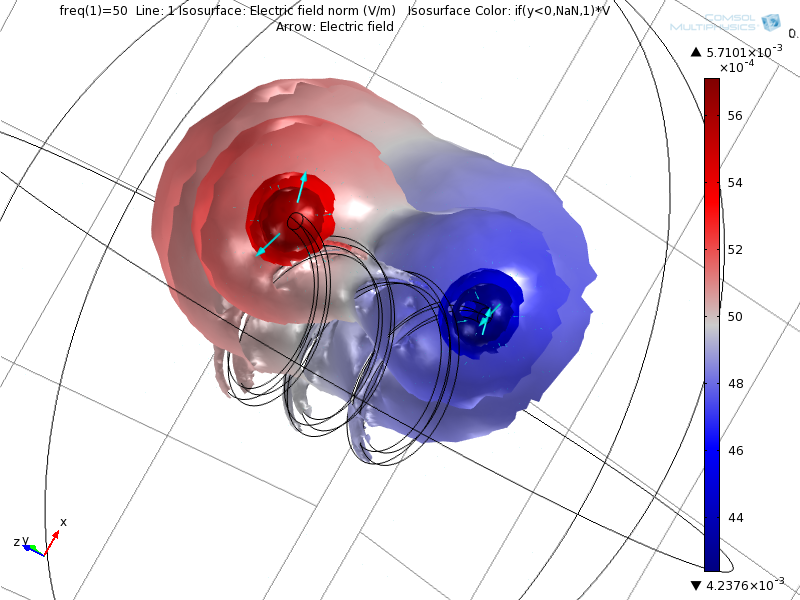

Posted: 1 decade ago 2011年6月17日 GMT+8 23:56
Dear Ralf,
At some points it seems to work but not all vectors are perpendicular to the surface ... see fig. (vectors have been normalized to show the direction more clearly). Thanks a lot for the suggestion though.
Ysbrand
Dear Ralf, At some points it seems to work but not all vectors are perpendicular to the surface ... see fig. (vectors have been normalized to show the direction more clearly). Thanks a lot for the suggestion though. Ysbrand
