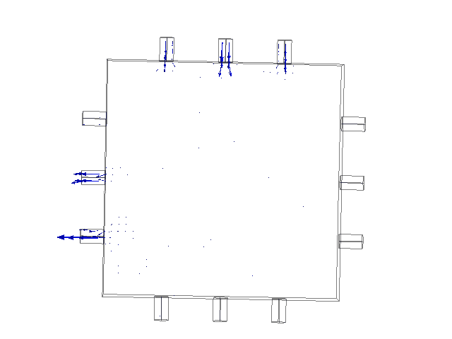

I've changed the model, I drawn just the water dominium which I want to study.
Now, do you know how could I see a video over liquid movement within the cell?

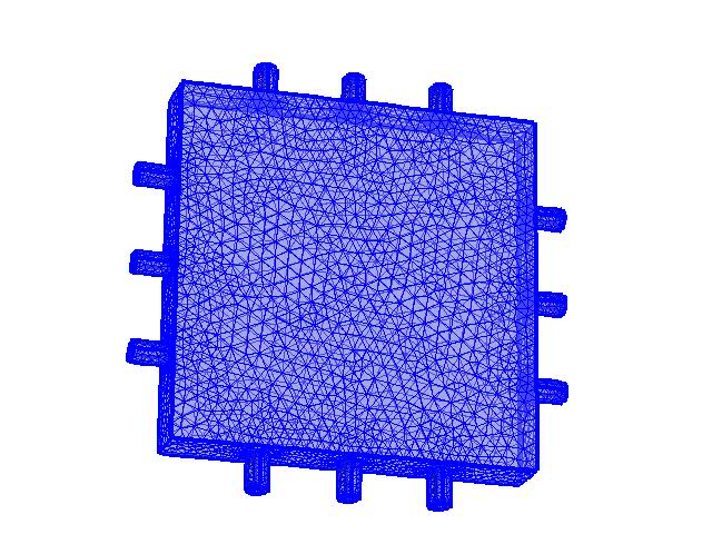

after a while I got results so I guess it has reached convergence(I had even changed the velocity so now Re is about 300). I've used a boundary layer mesh(image attached), honestly don't know why..

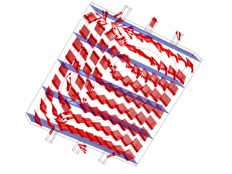

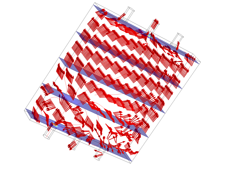

I've found the way to get the video(attached) but now the problem is that it seems to work in the opposite way, I mean since I've put a Volume force of 9.81*waterdensity N/m3 to simulate gravity force the water starts to move from the top(where are the outlets) to the bottom. That make sense because it is like if I had a over pressure acting from above downwards but It is not real because the fluid inlets are at the bottom

I did run the simulation and I am surprised it converged, there are still some issues regarding the mesh mostly. Boundary layer mesh is a 'must' in CFD but it might be better to have it finer by reducing the distance of the first layer form the wall. Again, it may be a good idea to try a real mesh, not only the size feature but actually write down something about free tethraedals or use a swept mesh.
Finally, I do not understand what you mean by "the water starts to move from the top(where are the outlets) to the bottom."
If you look at the pictures you can clearly see the arrows pointing from the inlet to the outlet, there is a lot of recirculation but it is fine, all in all the model seems to be working properly, and remember you defined one inlet and one outlet only. One picture was taken after 3 seconds and one after 30 seconds.

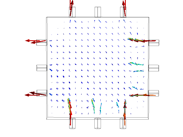

I've run a new model(model6 below) with more inlets and outlets, the result as you can watch in the picture is that the fluid is moving in the opposite way, I guess it is because of the Volume force but I don't know how to solve it.

I've run it without the Volume force and that is the image I got, that makes more sense to me, even if I know that isn't completely right.
Regards
You need to make sure first of all what you need in your model and then you may decide upon volume forces and so on, but I noticed you have not defined a mesh and you have not defined entrance lengths for the inlets nor for the otulets and you can see that the amount of mass flowing out of your domain is greater than the mass flwoing in even with fewer inlets and with the volume force acting.
