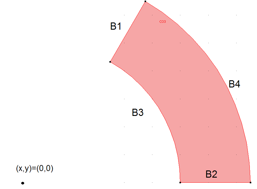

In my 2D cylindrical structural mechanics model, I am going to simulate almost a quarter of a rubber-like (hyperelastic) material tube (please see the attached picture) and stretch it circumferentially to make it a half tube. I have successfully done this in Cartesian coordinate, however, I prefer to do that in cylindrical system too.
In my V4.2 COMSOL, I have defined a cylindrical coordinate system, but I have problem correctly defining the boundary conditions. In the boundary condition menu, first I selected the Cylindrical coordinate system. For boundary # 3, the displacement in r-direction should be “r-R”, where r is the final radius (unknown) and R is initial radius, which is known. Of course I enter “sys2.r – R” as my Cyl. Coord. Sys. is sys2.

I beleive you are getting confused with the frames (I too get them always mixed up so I must recheck the convention regularly ;) when you define your cylindrical coordinates, you define the frame it applies on: Material frame the original geoemtry" or the spatial frame i.e. the deformed geoemtry, check carefully the doc.
then define your variables, you can make a "Definitions" variable my_R =sqrt(X^2+Y^2) and my_r=sqrt(x^2+y^2) then when you write "my_r-my_R" for any boundary or domain you will get the difference between the deformed and the undeformed shape (for a linear case it should also be close to "sqrt(u^2+v^2)" )
