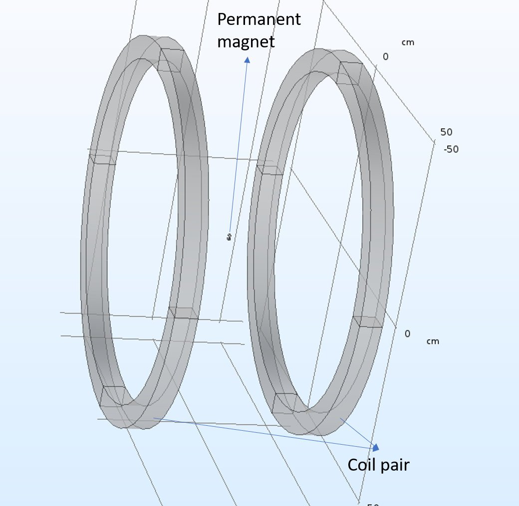

Basically, I am trying to find an magnetic interaction between 'rotating permanent magnet' in the magnetic field which is genereated by 'a pair of multi-turn coil' [Pic 1].

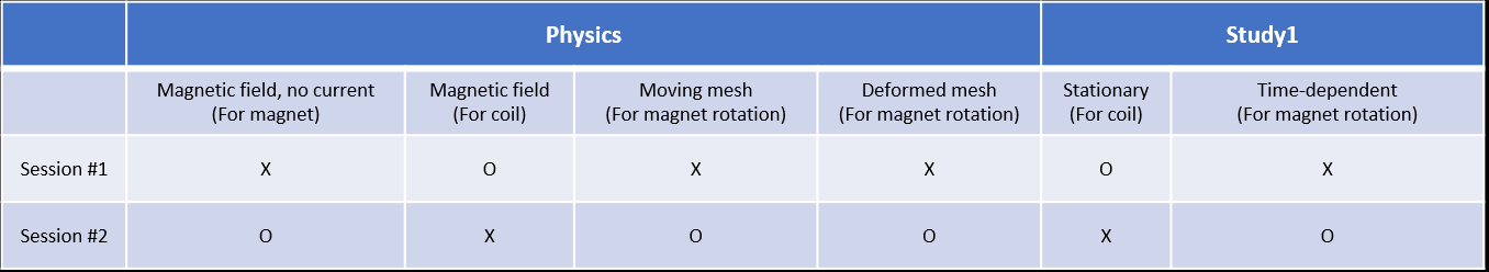

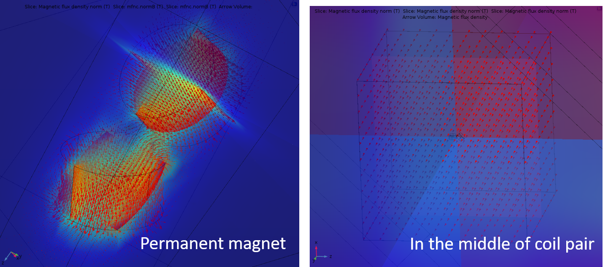

Independently computing 'time-dependent' and 'stationary study' one by one. ->Each result was established without error but not interacted. The magnetic field from magnet and coil is not mixed but independtly existed. [Pic 2, Pic 3]

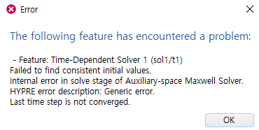

Processing all physics only with Time-dependent study ->Error: Failed to finding Initial vaue and Internal error [Pic 4]

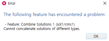

Right click 'study(time-dependent)' and tried 'Combined solution' ->Error: Cannot concatenate different types[Pic 5]
