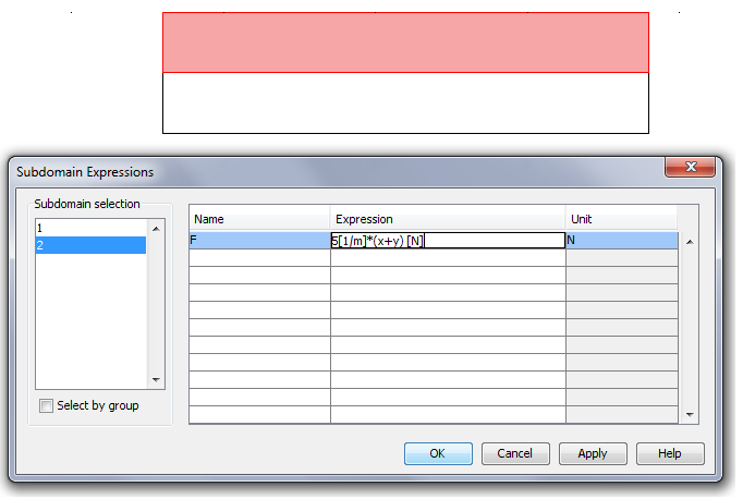

Only one thing is that I'm trying to vary the value of the Volume force based on the point in the bulk of the fluid i.e. to define the force in terms of x and y..
So I went to options, expressions and put F....Comsol couldn't identify F, and there was no option to define F as a force, since the description place could not be changed.
Then I tried defining the for as say F=5(x+y) Newton....and it kept giving an error!
I tried the same in Options--> Functions, and again with no luck.
Please tell me what could be wrong!
I tried out the model and it works just fine! Thanks for the guidance!! Only one thing is that I'm trying to vary the value of the Volume force based on the point in the bulk of the fluid i.e. to define the force in terms of x and y.. So I went to options, expressions and put F....Comsol couldn't identify F, and there was no option to define F as a force, since the description place could not be changed. Then I tried defining the for as say F=5(x+y) Newton....and it kept giving an error! I tried the same in Options--> Functions, and again with no luck. Please tell me what could be wrong!
Posted: 1 decade ago 2011年11月12日 GMT+8 22:04
I can see no error in the expression..have a look at the attached pic file...
cheers
I can see no error in the expression..have a look at the attached pic file... cheers
Posted: 1 decade ago 2011年11月13日 GMT+8 12:58

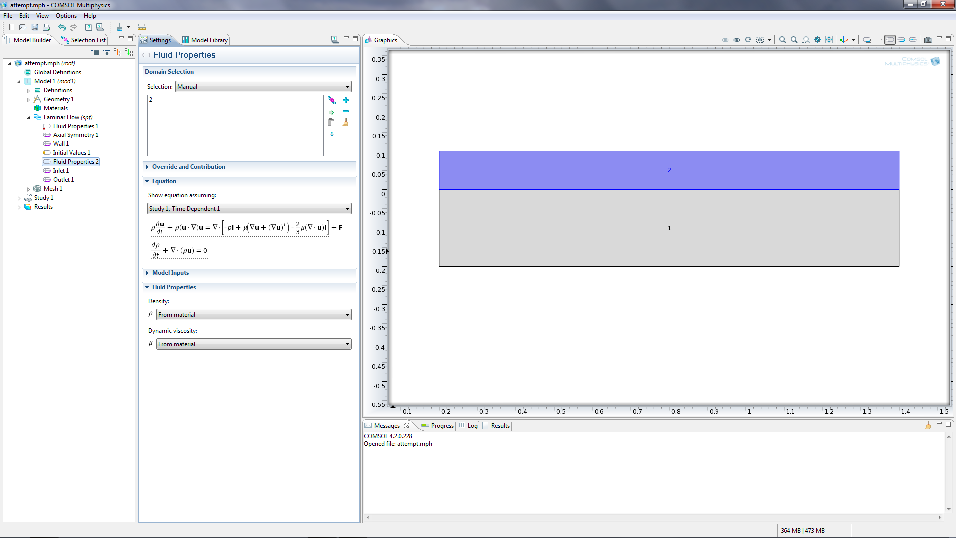

Due to certain problems, I've had to shift to COMSOL 4.0 version...in this, a unique problem that I'm facing is that when I select boundary conditions, whatever I apply to any one boundary gets applied to all of the boundaries...so basically I'm not being able to specify separate boundary conditions for each boundary...please help!
Hi, Due to certain problems, I've had to shift to COMSOL 4.0 version...in this, a unique problem that I'm facing is that when I select boundary conditions, whatever I apply to any one boundary gets applied to all of the boundaries...so basically I'm not being able to specify separate boundary conditions for each boundary...please help!
Posted: 1 decade ago 2011年12月2日 GMT+8 15:03
attach your model file..it should not be possible. Are you using Comsol 4.0 or 4.2a? the latest one is 4.2a. I recommend not to use 4.0, it had lot of problems, however i didn't face such boundary condition problem in 4.0.
Posted: 1 decade ago 2011年12月2日 GMT+8 21:04

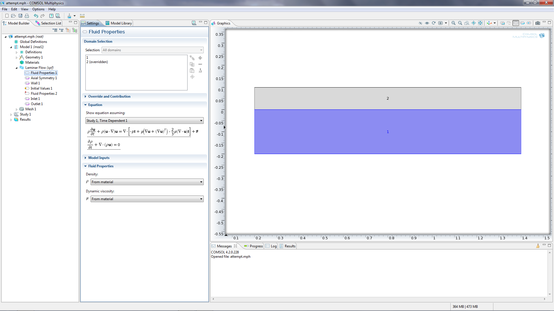

There's a place in the settings window, where it says 'All domains'...so whatever settings I apply to any one domain applies to all of them...all the boundaries etc etc...somehow I just can't change that....there's no option to make it from 'All Domains' to specified domains...
I really haven't done very much..I'm just trying to assign different boundary conditions to each of these boundaries..
Btw, what kind of problems did 4.0 have...I'm using 4.0,not 4.2....will they seriously disturb my work?
There's a place in the settings window, where it says 'All domains'...so whatever settings I apply to any one domain applies to all of them...all the boundaries etc etc...somehow I just can't change that....there's no option to make it from 'All Domains' to specified domains... I really haven't done very much..I'm just trying to assign different boundary conditions to each of these boundaries.. Btw, what kind of problems did 4.0 have...I'm using 4.0,not 4.2....will they seriously disturb my work?
Posted: 1 decade ago 2011年12月2日 GMT+8 23:31
you need to add extra boundary conditions; by default Comsol starts with one option for each "fluid properties 1", " Wall 1", "Initial values 1", if axial symmetry then "Axial symmetry 1". Now to add inlet, outlet or if you want to define second sub-domain with different fluid properties then right click on "Lamina Flow (spf)" and add whatever you want. e.g. after adding extra "Fluid properties 2" you can go the geometry window, select and right click whichever domain you want to add under Fluid properties 2; similar procedure apply for boundary selection.
I don't have 4.0 on my workstation and you can not open any file saved using 4.2a in 4.0, so I am not attaching the modified file..though I have attached couple of snaps for your reference.
you need to add extra boundary conditions; by default Comsol starts with one option for each "fluid properties 1", " Wall 1", "Initial values 1", if axial symmetry then "Axial symmetry 1". Now to add inlet, outlet or if you want to define second sub-domain with different fluid properties then right click on "Lamina Flow (spf)" and add whatever you want. e.g. after adding extra "Fluid properties 2" you can go the geometry window, select and right click whichever domain you want to add under Fluid properties 2; similar procedure apply for boundary selection. I don't have 4.0 on my workstation and you can not open any file saved using 4.2a in 4.0, so I am not attaching the modified file..though I have attached couple of snaps for your reference.
Posted: 1 decade ago 2011年12月2日 GMT+8 23:40
4.0 has lot of problems, even 4.2a has few but much better than 4.0. So I recommend not to use 4.0. If you don't have technical and product update supports, continue with 3.5a. I loved 3.5a and I am still using it.
Posted: 1 decade ago 2011年12月3日 GMT+8 14:05
